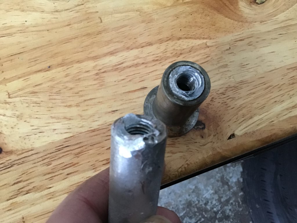

I have to agree, I bent a stock shaft, broke the rr shaft and took out my tunnel with it. Rr shaft failed during regular trail riding at about the 3500 mile mark for me. Luckily my dealer got the tunnel replaced under warranty for me. I now have the BOP sleeve over a stock shaft and 2500 miles later I've seen zero signs of wear and zero belief this shaft will have any failures like the 2 stock offerings.Hi yamamarc.
wrapped your headers is not a good idea. Ask your manufacturer....!
RR crossshaft have the same weakness than stock.( bushing)View attachment 154801
You would be a LOT better whit PEFI strong shaft or BOP.

Why are these upper cross shafts breaking ? This is the first year that I've heard of so many of them breaking yet there is so many out there with no issues

Mine was bent!! Probably from hammering big bumps at high speeds!!Why are these upper cross shafts breaking ? This is the first year that I've heard of so many of them breaking yet there is so many out there with no issues
I remember this season I launched off a hill and landed on another mogul! It hit hard and almost threw me off. I thought for sure something was broke but all was good. And now i found the shaft bent. I am guessing it bent from the impact
Buddy had his cross shaft fail a few weeks back. Needs a new tunnel, drive axle assembly, track, and front heat exchanger.
Insurance is writing the sled off.

I have seen a Lotsssssss of them since 2013..... everybody i know have minimum rr shaft which is just a litle bit strongerWhy are these upper cross shafts breaking ? This is the first year that I've heard of so many of them breaking yet there is so many out there with no issues

I was lucky to have the bop tunnel reinforcement on it! It have save the tunnelI have to agree, I bent a stock shaft, broke the rr shaft and took out my tunnel with it. Rr shaft failed during regular trail riding at about the 3500 mile mark for me. Luckily my dealer got the tunnel replaced under warranty for me. I now have the BOP sleeve over a stock shaft and 2500 miles later I've seen zero signs of wear and zero belief this shaft will have any failures like the 2 stock offerings.
Great upgrade for little $$$.....
I actually had the external plates riveted into the outside of the tunnel where the cross shaft bolts mount. It stopped it from being more catastrophic than it was/could have been at least. At a minimum it stopped the bolts from pulling completely though the side of the tunnel during my failure.
