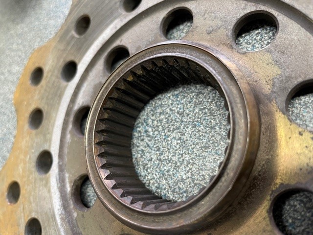

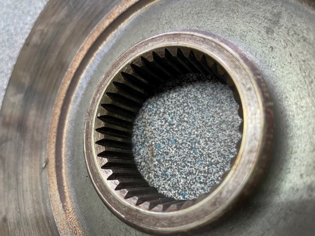

I get a lot of people that ask me what the easiest method is to determine if the drive shaft has been spinning so I wanted to share my findings. I find that removing the brake rotor and inspecting the backside of the hub is the quickest way to determine if you have an issue. If the shaft has spun, the face of the hub that seats against the bearing inner race will have lips worn on it. If you drag your fingernail across the face and it catches 2 lips/burrs then the shaft has spun. The bigger the lip, the more wear the shaft likely has. Below are some pictures. First picture is a perfect face. Second has slight lip, and the 3rd was removed from a sled with .015 of wear on the shaft.

And usually when it gets grooved enough its a real bear to pull off.
