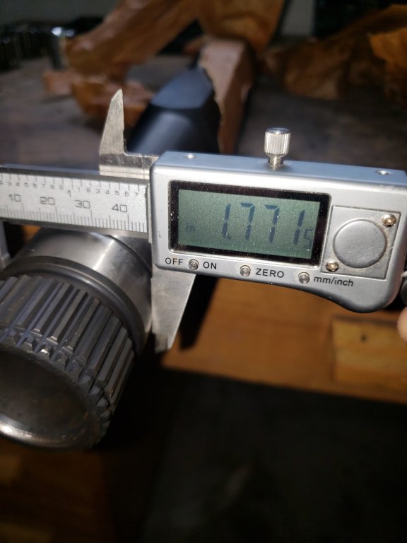

This one has 8000km! But the brake rotor was hit so I am sure this is the root cause for destroying the bearing!! the loose fitted bearing most likely contributed also to the messHow many miles are on that sled?

Just loosen track and pull the caliper and check you may be ok but definitely check it.How many miles are on that sled?
I was considering letting my driveshaft be this year (it already has 1200 miles without mcwedgey) and replacing it next year after all the bad shafts are out of the supply chain while doing the track next fall...
If shaft not worn add retaining compound and run it

FYI- many good used calipers available from the mountain guys out west. Many with very few miles on them. eBay $30-$40I will be listing and pricing parts today and getting him a total.

This might be a first. My buddy had a new shaft (allegedly) installed by a dealer last summer that was under warranty. He had the BOP saver and set it to 45lbs. All should be good...right? Not at all, we knew something wasn't right when we pulled the caliper for a bearing change and it just slid off the new shaft. Put the new SKF bearing on the shaft and were blown away by how loose it was. We pulled the shaft at this point and put a mic on it and it had worn over 10 thousands. Here is the shitty part, written on the shaft with a yellow grease marker was "17 ZR 9000". His sled is a 18 Tcat. I think the dealer pulled a fast one here. Not only do individuals cover up damage but so do dealers. Really good , honest dealers are hard to come by.I will be listing and pricing parts today and getting him a total.
