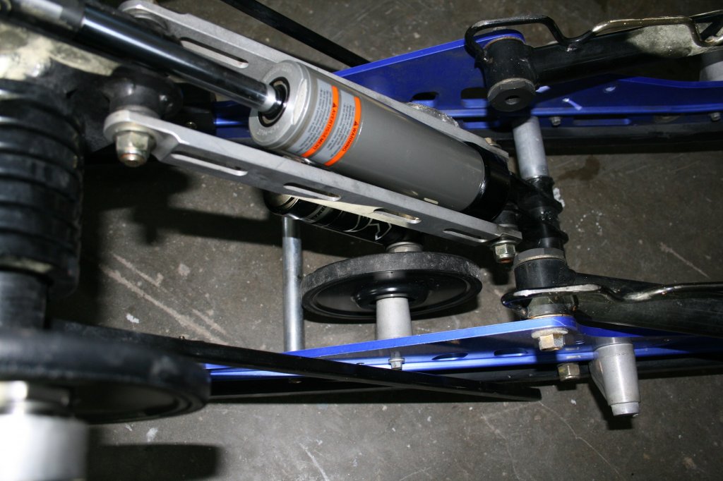

Setback. Was greasing it up and found front arm cracked. Shouldn't affect speed but won't be taking Viper to Muni tomorrow
Out of stock for over a month. Wow! Will be reinforcing the old.
Wow I guess the RR skid IS quite different. I never really compared the two. The RR front arm is on stubs with no shaft connecting the rails. The shock pivot is on a lower shaft. That explains why the wheels can be inboard on the std skid and not the RR.
Yup. Guess what I am riding this weekend. Broke first arm when valving my stock center shock in the first year. Now I switched to the Axis and bang another arm. Its not fun or cheap getting shocks to work right.Wow I guess the RR skid IS quite different. I never really compared the two. The RR front arm is on stubs with no shaft connecting the rails. The shock pivot is on a lower shaft. That explains why the wheels can be inboard on the std skid and not the RR.
Swap skids?
