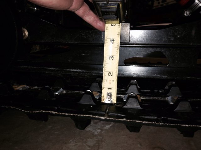

What's the consensus? Tight or loose. Not worried about centering. Gave up on that long ago and no issues. This is what I have been running all year.
View attachment 103851 View attachment 103852
What do you mean you gave up on centering ?
I've always noticed that my track is not equidistant on both sides. Asked my mechanic twice and he said all was well. I've had no issues either.
Exactly as you describe. Track goes where it wants loose or tight. No issues so all I do is count turns on adjuster from flush and do both sides equal. Works fine.
