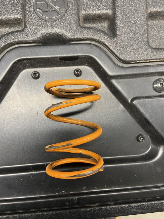

That orange spring doesn't have coil bind. If you were having coil bind, you would have paint worn off between the coils and I am not seeing that. My TP Orange primary spring has the paint worn off on the outside just like yours.Here’s some pictures

That spring is wearing paint off because it’s hitting the spring cup sides. I can assure you the 2 springs I recommended will not look like that in 10k miles. Coil bind may have been the incorrect term but no way a spring should look like that. It’s hitting something clearly and slowing down the shift of the clutch.That orange spring doesn't have coil bind. If you were having coil bind, you would have paint worn off between the coils and I am not seeing that. My TP Orange primary spring has the paint worn off on the outside just like yours.

Another of the same brand. These marks will not help any clutch set up. I call it like I see it. I will again repeat I like thunder products and use them just not this spring

Yellow green yellow Yamaha. 10k + miles. The paint marks got swirled from brake cleaner.
