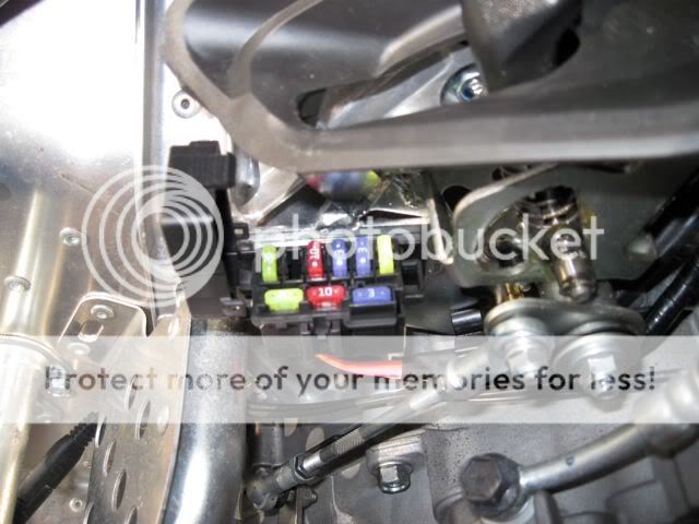

Rock-I bought my Yamaheater kit from you last winter and I don't recall having to up the fuse resistance for the Sig wiring. I checked my fuse and it's a 3 amp. My buddy who just purchased a Yamaheater kit from you said he had to up the fuse to a 15 amp. Has something changed in the latest batch of Yamaheaters or did I miss that step in the instructions?
Hi Dude!
You did fine!
The kit has changed a bit since you got yours, and functions the exact same with the same current draw.
The only difference is where we tap into for the power.
On yours, it is through the fuse holder/Red wire provided.
On his, the power is drawn from the SIG circuit, that is why the fuse change on his.
You do not have to change the SIG fuse on yours. ;)!
We did this to help simplify installation for the Plug & Play kits, that way, you litterally simply Plug the YamaHeater in and it works!
(One less wire to run & connect for you.) :Rockon:
Hope this helps!
Rockmeister :-o
