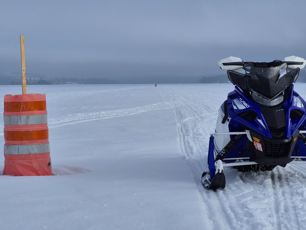

Did a little tuning today. I had to start two barrels back and when I hit the second barrel I went wot....those were the best conditions, couldn't get traction from the dig!
Had to put two more grams of weight in clutch, play with fuel pressure, Yada, Yada
Turbo Dynamics MS17
15.3mpg
76.2g @ 8900
Afr 11.6
Boost 17.6psi and held it.
I'm running/tuning in 36°. So everything should be alot closer at 10°. rpms go up, afr will settle in.
But I have to say....she's pretty stout.

Sure is a nice looking sled...hard to beat yammmy blue and white, also like the control arms level with the world, keep digg'n old friend.Did a little tuning today. I had to start two barrels back and when I hit the second barrel I went wot....those were the best conditions, couldn't get traction from the dig!
76.2g @ 8900
Afr 11.6
I'm running/tuning in 36°. So everything should be alot closer at 10°. rpms go up, afr will come down.

That you for the kind words and wisdom, in initiating the work done on my turbo!Sure is a nice looking sled...hard to beat yammmy blue and white, also like the control arms level with the world, keep digg'n old friend.
BTW...still have a couple things I'm working on. Lol. But this wasn't the trip for that.
Need to get a baseline on things moving forward.
Thank you, fords4life

What lake are you running on?
Doc Harley
- Oct 17, 2016
- 3,817
- 1,887
- 1,503
- Here & there
- '17 Sidewinder LTX SE
Sunrise lodge on Lac Vieux DesertWhat lake are you running on?
