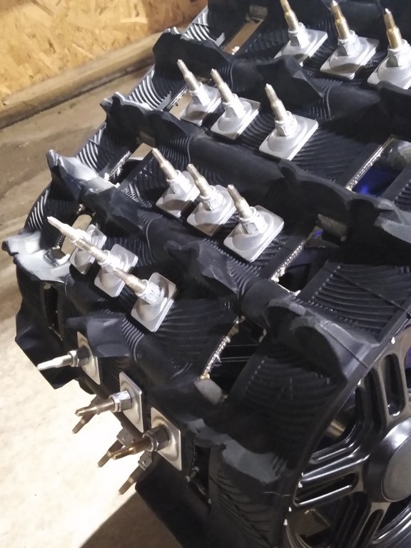

Yes! I've already went with 1.63" trail studs with angled backers up the gut.5 studs per bar at least .1575 with blocks pulled (leave the bar) and a stiffer spring in the front of the skid will probably hook pretty well. Mine hooks hard and lifts the front end almost too much with this set up. (with stock Tcat gears)
I wonder if straight 1.575" on the outside would work??? If so, which Woody's stud?

I know those are new studs, but I bet even new studs can be made sharper with a stud sharpener tool.Yes! I've already went with 1.63" trail studs with angled backers up the gut.
Keep them super sharp, it will be the difference between cutting a T-bone with a steak knife compared to a butter knife.

I have a Woody's, as you suggested last time.I know those are new studs, but I bet even new studs can be made sharper with a stud sharpener tool.

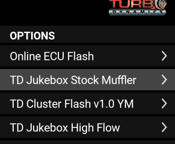

Earlier in the year I was troubleshooting a boost creep issue on my SW and I actually tried selecting the stock muffler tune bundle using my TD 3" stock mod muffler and carefully monitored my AFRs as well as data logged with Boostane in the fuel.[I never would have tried this without closed loop]Great read Motorhead. I'm positive others are running some sort of pm on non pm tunes. Another member suggested it to me, and I believe it's not as bad as some would suggest. Especially with my low performing muffler. Lol.
Would be nice to see some AFR ratios. Just to help swallow the pill.
The sleds AFRs seemed OK but I have closed loop and it was adding up to 25% fuel at full throttle to keep the AFRs close to the tune requirements so I would caution against trying this without closed loop.
