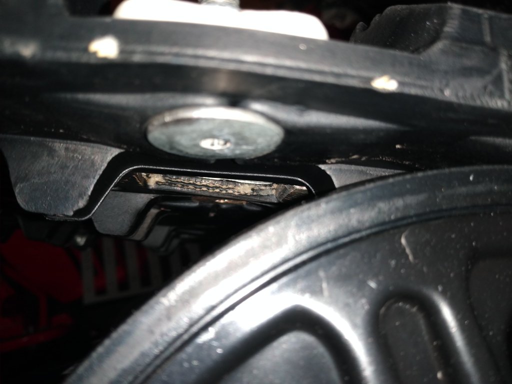

Tried to add some traction to the outside, today.
Before I can get the stud to set into the silent nub, the nut is driving a hole through the backer.
These backers have an expiration date?!?!

Sadly, I use aluminum backers for this exact reason! LOLTried to add some traction to the outside, today.

I've got 4,200 miles on them. And with that said, I'll never buy them again. TrashSadly, I use aluminum backers for this exact reason! LOL
- 5,709
- 4,306
I'm not a fan of aluminum because after a few years they become brittle and crack or break.
JT, why don't you use the pro-series and thread them first?

Sorry for your troubles.
That little pad makes it hard for the stud to suck into the track. The aluminum backers will stop the nut and let it suck into the rubber. You will also need to tighten it again after riding it. I have thousands of miles on aluminum backers have only wrecked a handful over the years.
I always order a "non quiet" fully clipped track when ordering a replacement.

Well, with the thought of snow coming here in the next days, thought I'd run some old studs & backers in the outside of track. I'm like, what the hell?!?! "Last minute Lucy" idea. Lol.I'm not a fan of aluminum because after a few years they become brittle and crack or break.
Yep, already started a Christmas wish list for next year.I always order a "non quiet" fully clipped track when ordering a replacement.

Tomorrow I'll try to use a washer under the nut. See how that goes.
