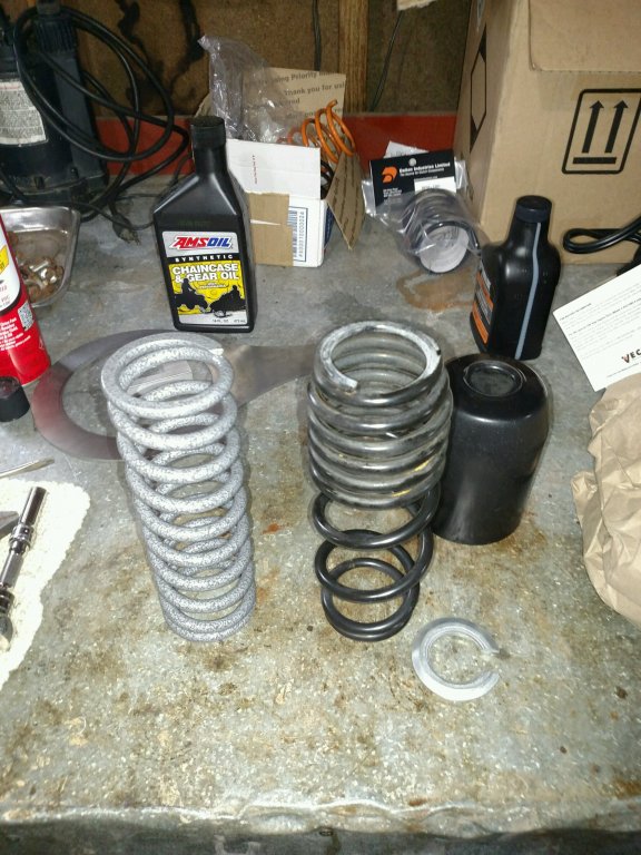

This. I have more coming. Just sold my last one. $70 160lb Bill Mohr center shock spring. I do have my used one I could sell for $50 if in a hurry.

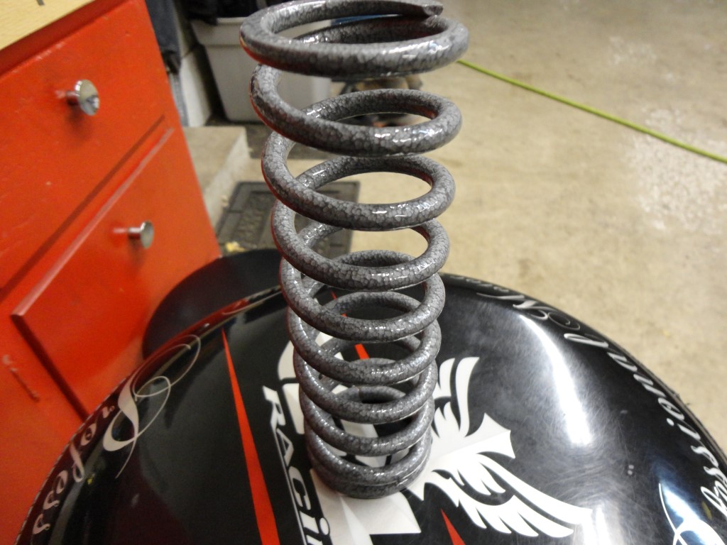

1nc 2000
Lifetime Member Tim
- Feb 26, 2010
- 3,373
- 2,771
- Marquette, MI
- Yamaha FX Nytro RTX SE
This is off my XTX 137 LE with the standard hpg shock on the center.

That's it exactly...I think he got them from Cannondale.View attachment 143066 Stock spring on right. 110lb spring. Cannondale spring on left. 160 lb spring.
