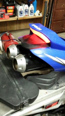

The exhaust is AAEN and has removeable inserts to try to keep it quiet.....the video you hear is with the inserts in. I really like the design and I think it would be very easy to duplicate with a couple mufflers. I will get dimensions for you and where I cut the stock exhaust.

Great, I built the exhaust on my rx1 and she would like to do something for her sled so it doesn't sound like a tractor. I just have a hard time paying 4-600 bucks for something I can build for a 100 and a couple of hours.

Great, I built the exhaust on my rx1 and she would like to do something for her sled so it doesn't sound like a tractor. I just have a hard time paying 4-600 bucks for something I can build for a 100 and a couple of hours.![]()
Purple, here are some pics of the AAEN exhaust. Mufflers are 14 inches x 4 inch diameter round. The stock exhaust was cut right after the bend towards the engine.
Purplecoffin
Perfect!!! That takes a lot of the guess work out of these kind of projects. Thank you for taking the time to do that, Don.
