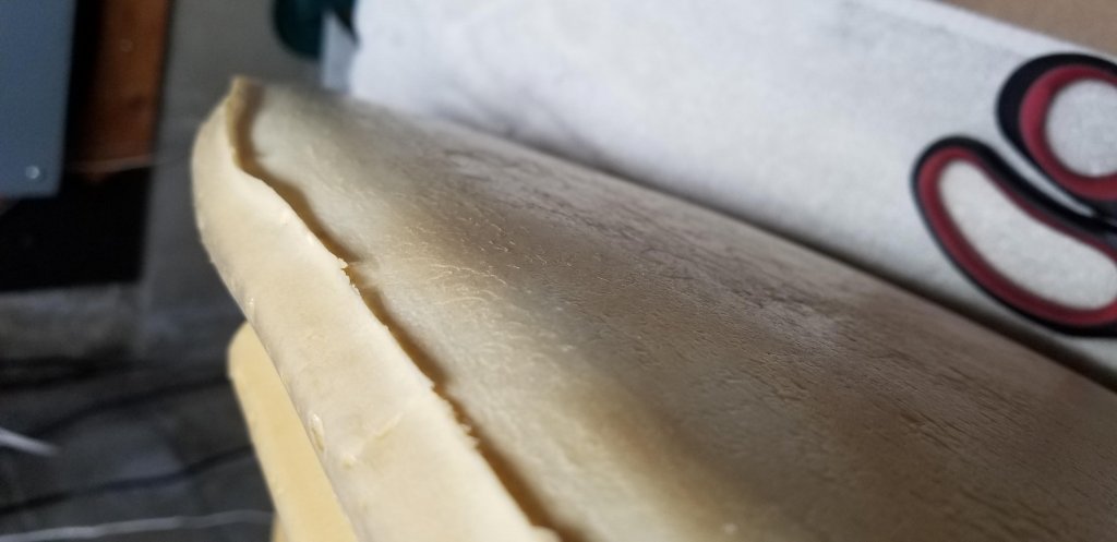

It's not horrible I am just OCD, you can finish it yourself to take out any imperfections with a razor blade or a foam scraper. You can just tell their not concerned with perfection. Looks like it was just taken out of the mold and slapped in a box looks like they never took the time to clean it up. I can tell from your pics that wrp took their time with the foam, rounded and cleaned it up nicely before they sent it. I did touch mine in several places before I installed the cover, but no I really wasent overly impressed with the quality of the foam. The seat cover itself was really nice quality.Yes its the heat demon. Sorry to hear the seat concepts may not be as precise. Was considering getting one for one of our other nytros.

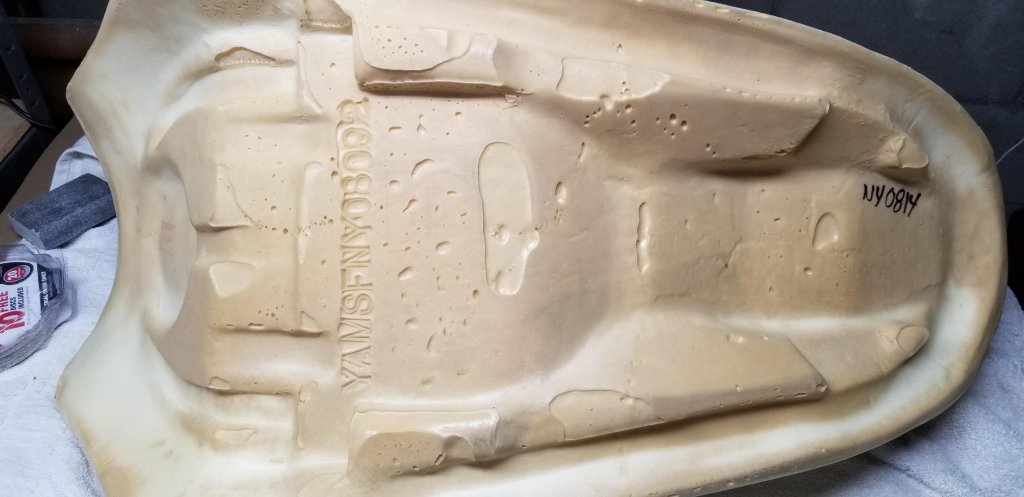

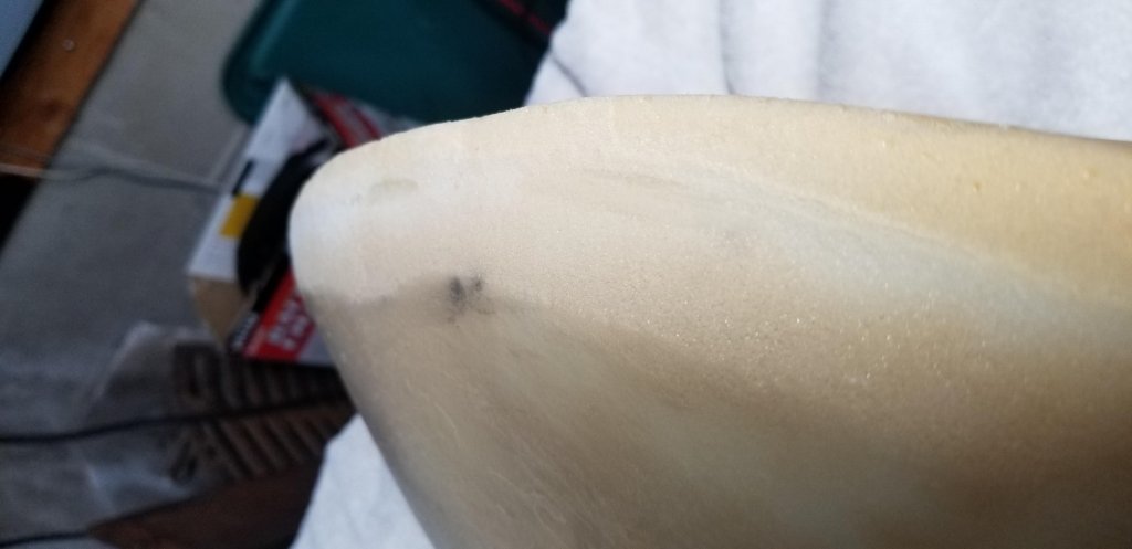

I went out and checked my foam after reading above and it appears to be the correct seat for a Nytro and smooth, a few mild mold marks but from what I have read in general not bad. I don't have an impression yet on the cover quality but seems pretty well made but time will tell. I was not aware of many Nytro options and the WRP form has good reviews so hoping this version lives up to their reputation.

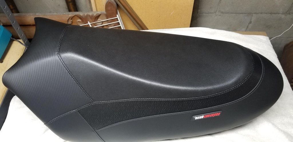

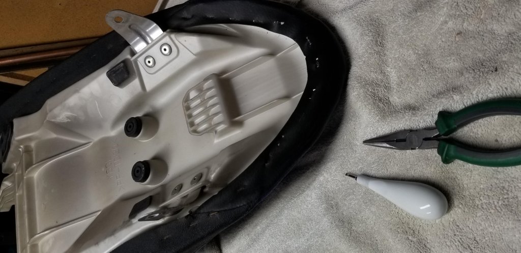

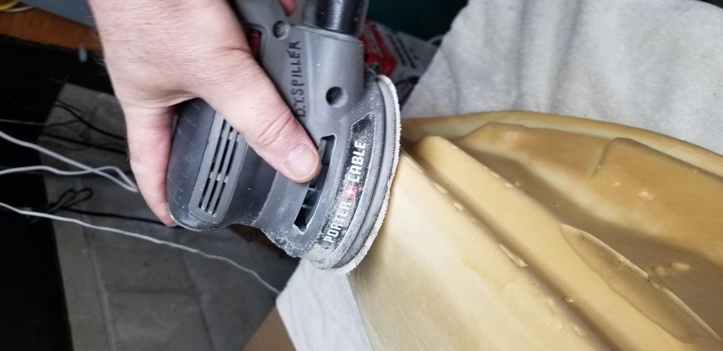

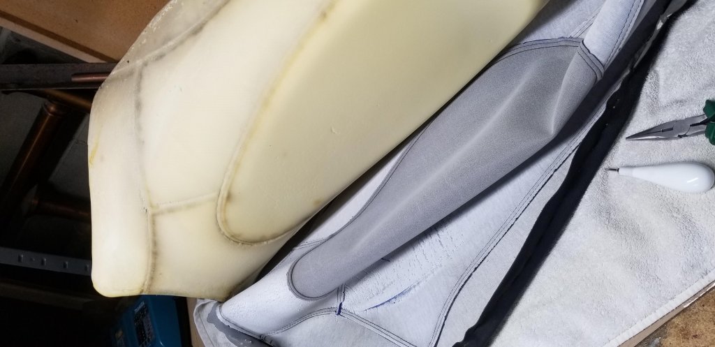

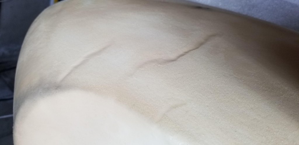

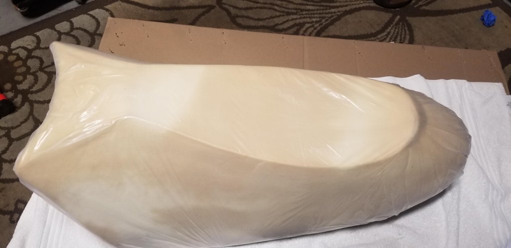

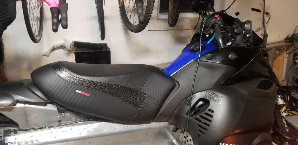

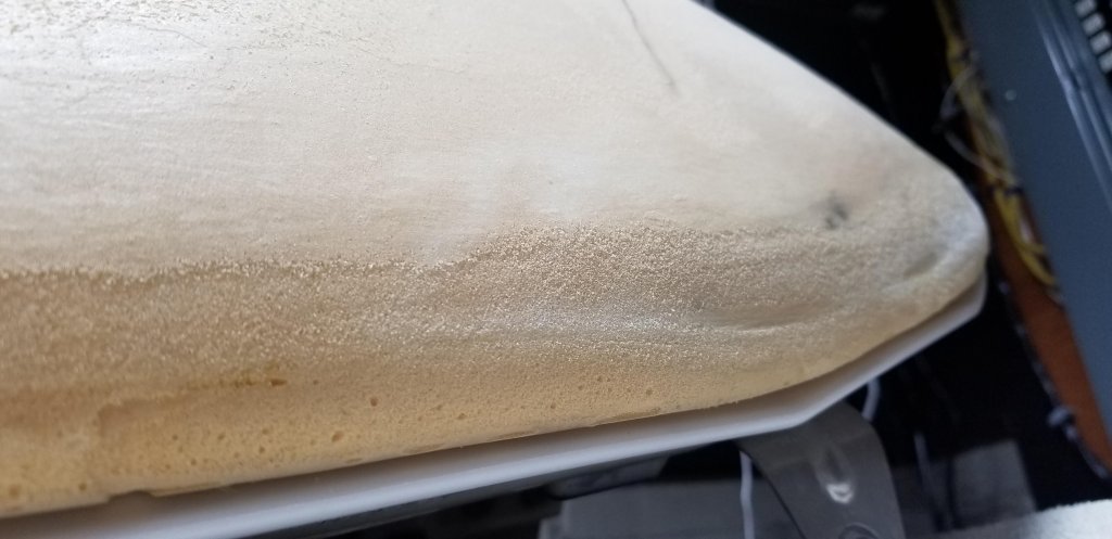

Finally had some time to get working on Nytro 2019 improvements (or are they 2020!). Considering we have no riding in Maine, we will call them 2020 improvements. So I started with my new Seat Concepts (previously WRP) taller seat upgrade. I know zip about seat upholstery so did some youtube lookups. I found a motorcycle seat video that was helpful as some have noted that their seat foam was "rough" from the mfg. This is true, mine was not ready for installation as received (and as I learned on the motorcycle video). They have a foam "rasp" which of course I did not have but I just bought some sanding disc "screens" for my orbital sander and they worked GREAT! Very little material comes off so I could not screw it up! As the pictures show (and I posted a lot as nobody seems to post the details, just before and after), there was a lot of "shaping" and final smoothing out to do. ANY imperfection that protrudes will be felt after the cover is installed. Dimples and other foam mold imperfections (I had three large lines on the rear) are not a big deal and you cant feel or see them after the cover is on. I am glad I did not just install the foam as is and took the time to smooth out all the foam seams where the two halves of the mold came together. When I removed the existing Yamaha seat I was surprised only the front lip was glued down, the rest was free floating. The Seat Concepts instructions were generic and not super helpful. I noticed the foam fit perfectly into the seat pan so no need for the "white EPS foam spacer" they mention in Step #4. They also make no mention of smoothing out the foam or provide any details on the glue step "how to"... Next post will show the glue step.

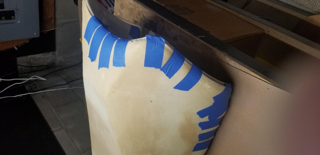

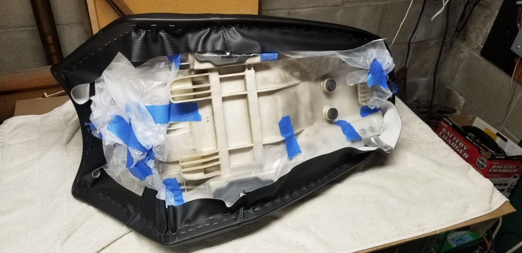

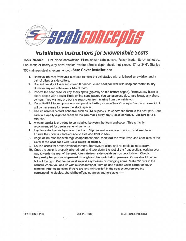

Ok, now the fun experiment with the spray adhesive. Totally by luck I bought a can of 3M Super-77 spray adhesive to glue some photos onto foam board for a show I was attending... perfect, I had the right stuff. So the glue goes on super thin and goes from thin liquid to tacky to dry fast so no screwing around. I decided to hit the entire pan and foam even though the Yamaha only glued the lip. I think it was the right call but this stuff sticks, do some dry runs as you don't have a 2nd chance for the first adhesion. I lined up the large blocks on the bottom of the seat as they press forward and line up the front edge (critical) so the foam seems like it stick up over the front of the pan which I learned is what you want. As you can see in the first two pictures the initial glue did not capture the edges, impossible to get to them all before the glue dried up. I debated if it was really critical to glue the edges to the pan and decided to err on the side of caution and glue everything up tight (I don't plan to ever install another seat on this sled). The system that ended up working the best was to hold the foam back on a small 6" section of the seat (I started with the front) and spray in glue to wet both the foam and seat pan, then pull the foam (pull hard) out and into position as flush with the edge of the plastic pan as possible. The Yamaha foam actually overlapped the pan but the new foam did not have the same thin foam edge to overlap so I improvised. I am glad I did this as I suspect relying on the cover to hold the edge down over time stretches the cover (others with a WRP might have real experience with this). Anyways, I used a pair of clamps on the front edge and taped next to it. As you can see in the picture what I thought was a huge overlap on the front edge aligned perfectly when I glued the edges down. I went around the entire seat this way, foam was solid and tight to the pan when done. Ready for next step, the cover...

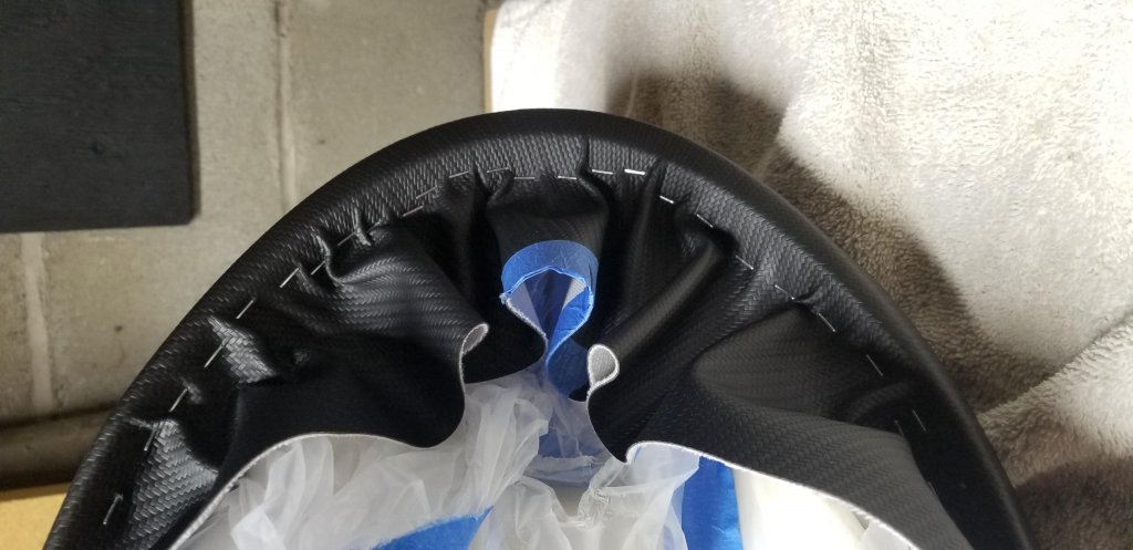

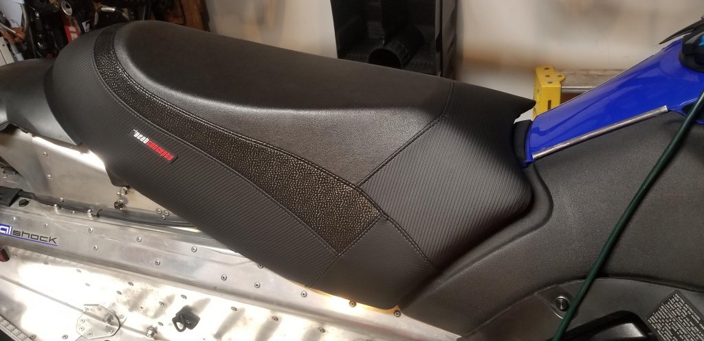

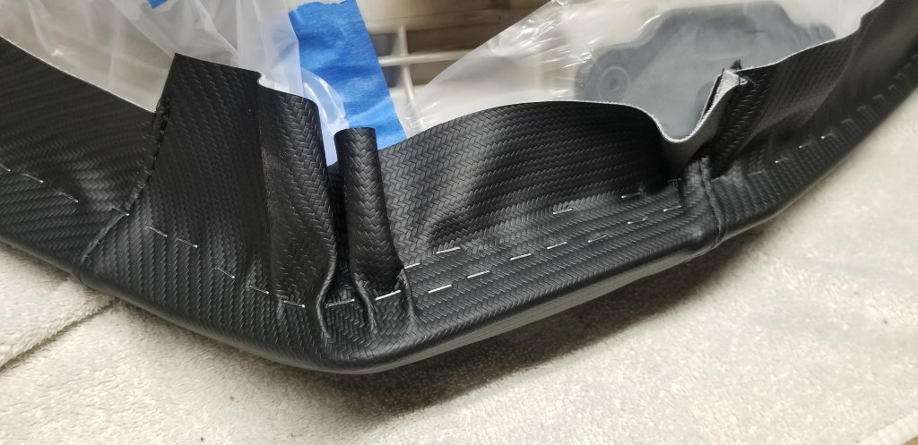

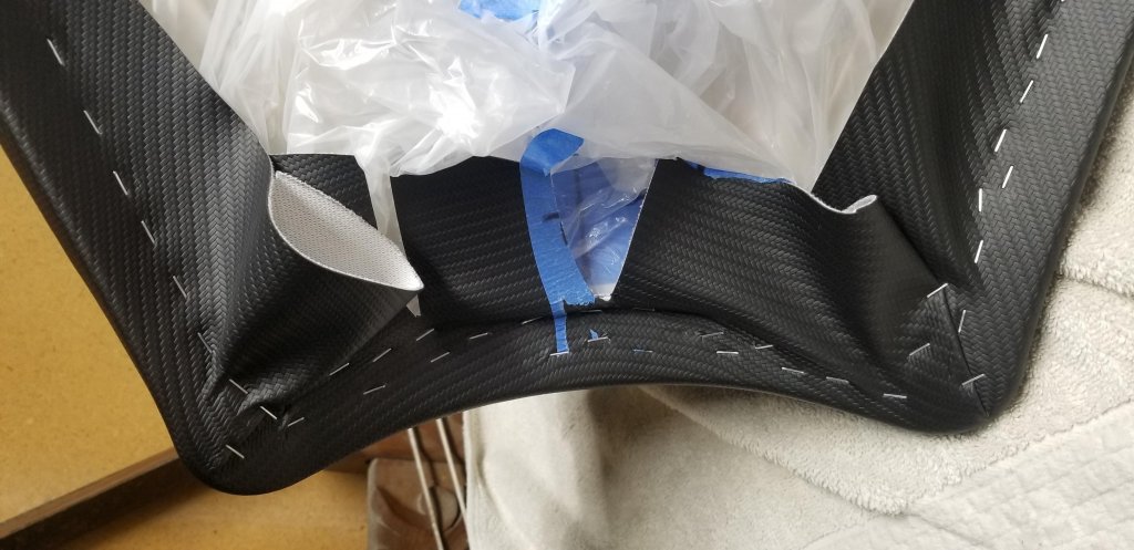

So with zero experience but plenty of time, I started with the water shield, nothing more than a super thin sheet of plastic (think cheap paint tarp). I was not sure about even using this as the Yamaha did not have one but decided to go with it, went on easy enough and I taped it to the bottom pan and it never really got in the way and you can cant feel any of the areas it was doubled up on the corners through the cover. I tacked the front and then stretched the rear with the help of my Brother-in-law to check position and realized that the front has to go another 1.5" forward as the seat is designed so that the part you sit on overlaps the foam top edges all the way around (a picture of the end product would have been super helpful in the instructions). Anyways, after tacking, stretching, carefully pulling out the staples with a thin screwdriver so as to no rip the cover, I had things in position where I thought after stretching out the rear it would be where I wanted it... this was a total guess as the cover has a lot of stretch... the system used was a 2x4x8 sitting on two milk crates and my helper on top stretching the cover evenly with one hand on each side of the cover and me underneath stapling (and trying not to shoot a staple at my helper!). The pneumatic stapler was a huge help and used same depth staples as Yamaha did albeit slight smaller. The instructions say don't overtighten the cover but I wanted to duplicate what the stock seat tension was like which was pretty tight so I did not hold back too much on tension, results look fantastic so I would say go tight and you will get what you want. After going all the way around using the 2x4 method, I then went around again and actually removed most of the first staples and did a 4" section at a time with the pan side up as I could control the stapler and make sure every staple was tight. This cleaned up the crazy line of staples that I did while on my back with 8" of working space! End result as you can see in the picture looks really good to me. The cover it tight but not overly tight (I hope). There is some space between the seat cover and the little flip up on the rear of the seat and no amount of tensioning could eliminate it, just the way it was designed I guess but I think the Yamaha seat has the same thing. Last step is to do final trim and then install on sled after I put on the black tank cover panel. I dry fit it on the sled and think it looks fantastic. Appears to be very high quality cover materials (just like the old WRPs I think) and after sanding the foam, the foam too seems solid. I like the overall look and as noted guessed right on the final tacking of the front of the cover as the rear of the seat perfectly lines up with about a 3/4" reveal all the way around the "bump" with the top most flexible cover material where you sit down. Zero wrinkles and I am hopeful it will last many seasons, thanks Seat Concepts for supporting our Nytro habit! Happy New Year to all.

Looks great man...good job
