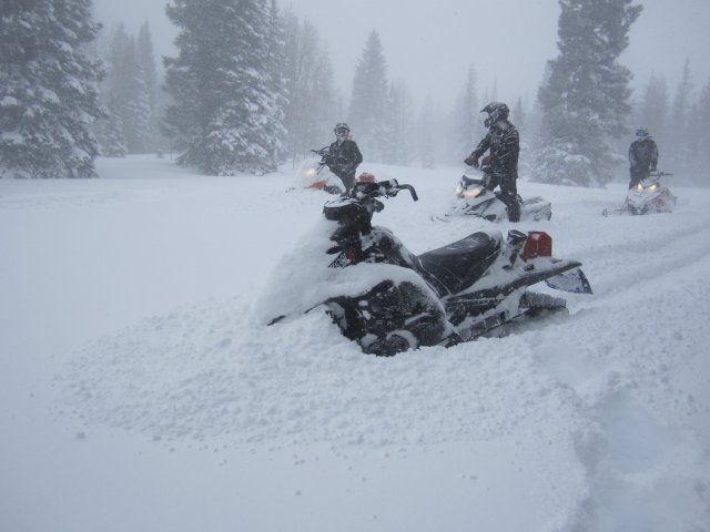

Here is the only pic I took all weekend. Our group is the definition of we don't care what brand you ride, just as long as you are there to have fun.
.....Well except for the skidouchebag... They are the same in any group....

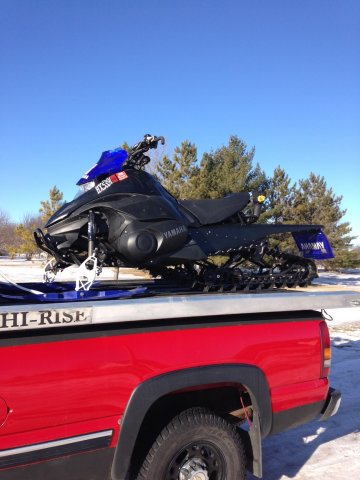

What did you make your running boards out of? I really like them. Thier badassHere is the final pics of it ready for the season.
LEE337
They are made from 0.625" 4130 tubing.

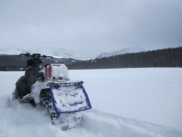

Forgot to upload some final pics for the year. This is our trip to CO first week of March.
What happened?

What happened in the one with the rope between the spindle and ski? looks like a broken lower heim joint maybe?
LEE337
I did not judge a tree's location correctly when I turned out on a hill climb. Whoopsie. At least it was the last day and not too far in.
