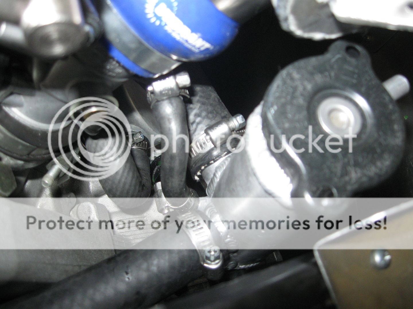

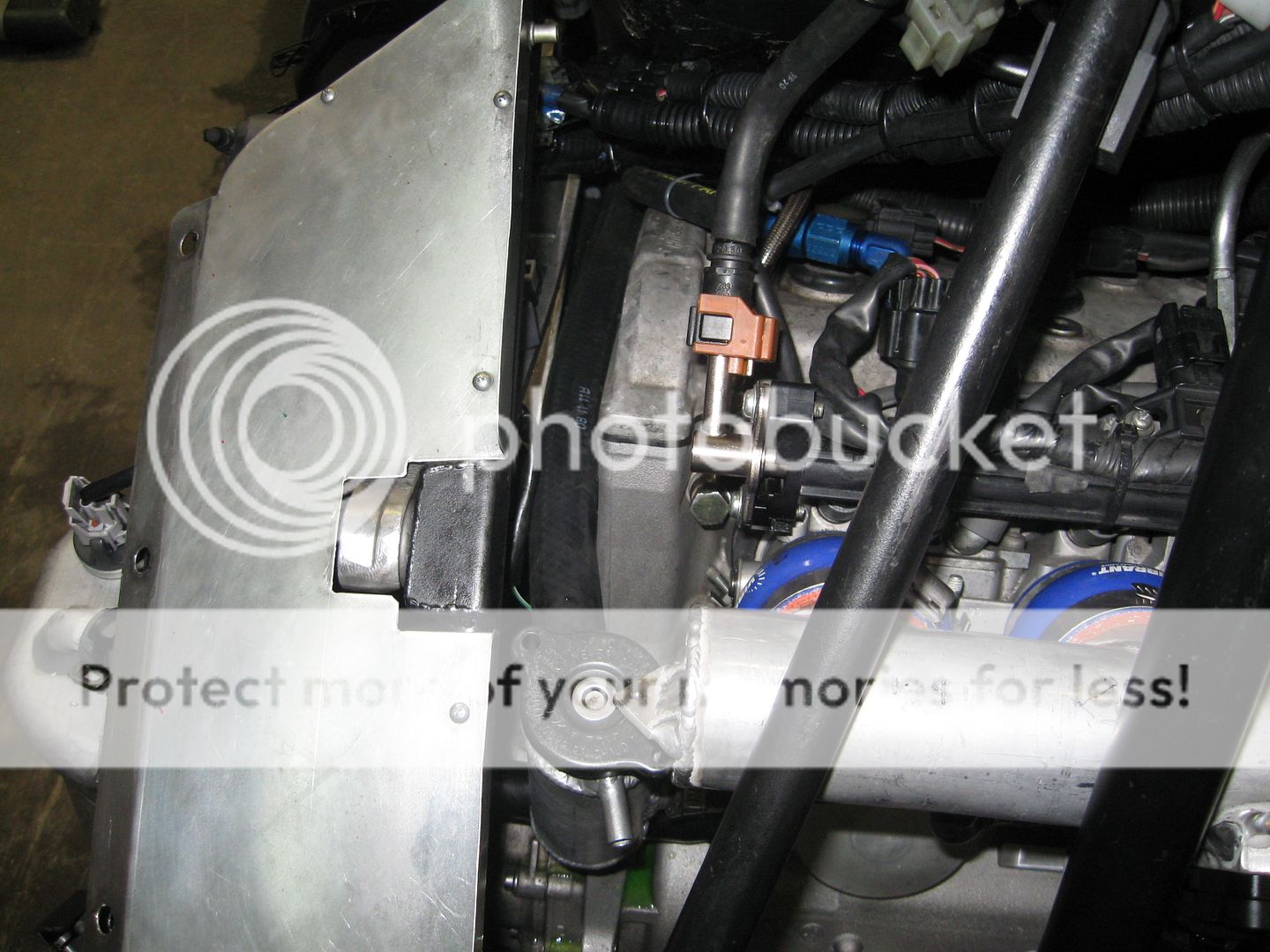

Started on the new coolant filler/reservoir, whatever you would call it. Just need to cap the bottom and weld the filler neck on.

Nikolai
Here you go.

So no thermostat?
Nikolai
Haven't ran one for a couple years.
How hard is that to get rid of? And what tempatures are you seeing? WhT are the pros/cons
Nikolai
Its as easy as opening up the thermostat housing cover (2 bolts) and pulling it out. I don't have a temp sensor so I couldn't tell you what my running temps are but I've never overheated.
There are no real pros or cons to removing it. I removed it because I had rerouted my cooling so it didn't really serve a purpose anymore. It's just in there to help the sled warm up quicker.
