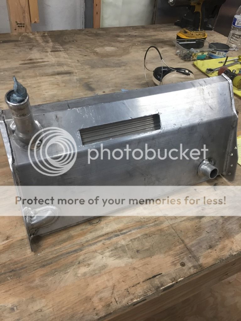

Probably had the cooler in and out another 10 times trimming it but it's as far forward and up as it can possible go.
After the final trimming.

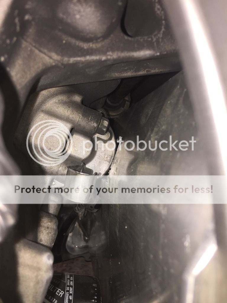

Oil filter clearance. I'll have to be sure and change the filter prior to installing the motor haha.

I've got about 3-1/16" from the drivers to the tightest spot of the cooler. Pulling it back out tomorrow to start prepping it for welding.

Looks great, oil changes sure will be fun now!
