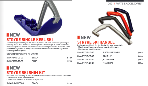

REALLY !Here's the part numbers from the online 2021 Accessory catalog:
It looks like they're still sorting out the prices.
STILL FIGURING OUT THE PRICING ???????
THE SEASON IS ALMOST OVER !
WTF !
