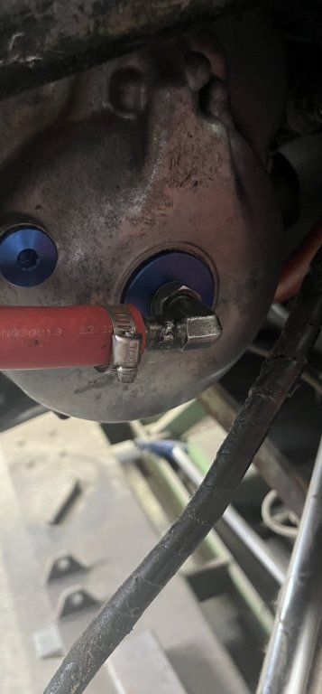

I want to move my turbo return oil line fom the timing check port to the center larger port in the stator cover and tap a An port into it . But I really dont want touse the nylon stock plug, does anyone here know of a after merket billet aluminum plug . I tried a YFZ450 but its to small

Found the correct plug, turned out good

You can drain the turbo oil back to behind the primary clutch as well. I have done it on a few units.

Since going oiless I now pull my crankcase EVAC from that port![Smiley Faces7 :-o :-o](/styles/default/xenforo/smilies/smiley-faces7.gif)

If you don't mind me asking , where did you find the plugthat

I ordered it from amazon, they will show differnt sizes though. The first one I ordered was too small so measure your plug. The plug needs to be drilled and tapped for a -8 oring boss port and the inside lip of the plug needs to be machined concaved to give a bit of distance between the flywheel bolt and the plug so it wont create a restriction to the return oil flowIf you don't mind me asking , where did you find the plugthat
NICECNC Blue Engine Plug Crankcase Cover Plug Compatible with Yamaha YZ250F 2001-2013 YZ450F 2003-2005 YZ400F/426F/450F 1998-2005 WR250R/X 2007-2017 WR250F 2001-2002 WR250FX 2008 WR400F/426F 1998-2002
