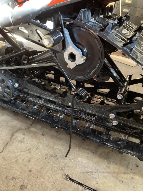

Bringing this thread up again. I installed the doo rail mounted scratchers last season after reading the info on here, but one of them broke. It was very icy that day so could have been a one-off issue, but I was thinking of trying the tunnel mounted scratchers instead. Anyone had any issues with those? I like that they have carbide tips and are away from the rails.

I installed these last year but never ended up needing to drop them.Bringing this thread up again. I installed the doo rail mounted scratchers last season after reading the info on here, but one of them broke. It was very icy that day so could have been a one-off issue, but I was thinking of trying the tunnel mounted scratchers instead. Anyone had any issues with those? I like that they have carbide tips and are away from the rails.

Does the mount bolt for that replace the bolt that holds the suspension up at the rear? I'm assuming it doesn't but it kind of looks like that in the picture. If so wouldn't that be a bad idea to put more stress on that bolt?I installed these last year but never ended up needing to drop them.
It does replace the bolt that mounts the rear suspension but there is a sleeve the spring rides on. I don't think it causes undue stress on the bolt. The bolt needed is a different size than what comes with the kit. I'll have to do some digging to find the specs if you go this route.

The original poster mentioned this:It does replace the bolt that mounts the rear suspension but there is a sleeve the spring rides on. I don't think it causes undue stress on the bolt. The bolt needed is a different size than what comes with the kit. I'll have to do some digging to find the specs if you go this route.
The bolt that I used to mount the ice scratchers was: M10X1.25X90.
About the stress on the bolt - I was just wondering if you somehow snagged the scratcher on something, if you'd be in a tough spot if you bent that bolt or something in the middle of nowhere. I don't have my sled nearby so I cant look at it - maybe that's not something to be concerned about.

I suppose anything is possible. On the BRP side, I've not heard of issues like you describe.The original poster mentioned this:

I’m running the tunnel ones that Mount through skid bolt on two sleds this year. I have already mounted On one sled. The bolts I used are available through country cat.
