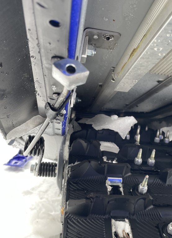

Yes I believe my torsion springs are week. Not sure why with only 1109 kms on sled and I never let sled sit when stored under its own weight. I posted recently here under topic “ bottoming out”. I tried to upload my photos this morning before driving home but they needed to be resized and my girlfriend was waiting in the truck to leave lol.I don’t think I would hit them if I bottomed that hard. Sounds like if you’re bottoming that bad you need different torsion spring in back.
Will try now.
shawnj
Especially on those photos that were uploaded.The track to hit, the sled would not only have to bottom out further than I have seen, it would have to move over quite a bit.
shawnj
shawnj
Comparing your left and my left tip, looks like yours might be inside about 1/3 of the carbide tip, mine looks like 1/2 if it is inside. My right side looks like maybe 1/4 of it stick inside. I could try and bend the bracket ever so slightly to bring it out a bit. With me alone on the sled I doubt it would touch unless I hit one hell of a jump.Pics

Yea I think it’s a bottom out issue. Yours look correct. They look same orientation as mine.

X2.The track to hit, the sled would not only have to bottom out further than I have seen, it would have to move over quite a bit.
shawnj
Yea I think it’s a bottom out issue. Yours look correct. They look same orientation as mine.![]()
shawnj
I bent the tab out a bit. Gained a bit. Wish I could have mounted the mounts about 1/4” lower but wasn’t able to as the holes would have been right on the edge of the aluminum plate under there.
