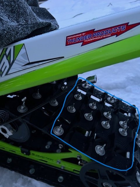

Sorry have to disagree slightly here. The BRP scratchers have been the best in our group hands down. Most times you only need one down that's how efficient they are. The mounting of these creates a TON of snow that's kicked up and onto the track which throws into exchangers instantly.I'm sure you know this but the further forward scratchers are mounted, the better they work. Scratching up snow behind the sled doesn't do any good.
Have you considered Duraflex? No problem with backing up with them down, carbide tips for long life, not in way adjusting track, etc.
DURAFLEX ICE SCRATCHERS™ - Between the Lines Designs
USPTO PATENT NUMBER US-7918298-B2 The innovative DuraFlex Ice Scratchers™ by Between the Lines Designs™ uses a durable steel cable in its design. We use hardened steel ends and a carbide tip. To ensure our corrosion proof design our scratchers undergo a zinc plating or “galvanization” process...betweenthelinesdesigns.com
The snow is being thrown into this area

I get complaints from the guys behind me about the cloud. Never had any heat problems with the BRP scratchers.Sorry have to disagree slightly here. The BRP scratchers have been the best in our group hands down. Most times you only need one down that's how efficient they are. The mounting of these creates a TON of snow that's kicked up and onto the track which throws into exchangers instantly.

I agree, that's where we want snow to go. Without saying it right, I was more referring to allot of ski-mounted stuff or scratchers that don't make a cloud behind sled.
Often, I too only have to have one down.
