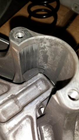

Did mine today and the small dremel bit worked very good.by no means am I a expert but a round file worked perfectly! not sure if a dremel bit will fit in the slot???

Cleaned up my casting flash today also, you could see where they tried cleaning it up but still had edge. Used a rat tail file, smooth windows now. Allan, how good/bad was your edge.

Mine was not that bad just had a edge you could feel.

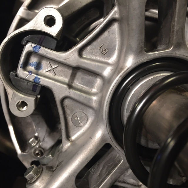

Reading through this made me check my clutches, especially for three things:
1) did I put the primary clutch cover back correctly after I installed the clutch kit.
- No, I didn't! :O
However, I'm not 100% sure what mark to look for. There is a X on both the clutch cover and the spider, but there are also pen marker marks, but they are all over the place so I went for the X
These are pen marker marks

It looks like someone cleaned out the flashes already, either at the factory or my dealer.
- No, I didn't! :O

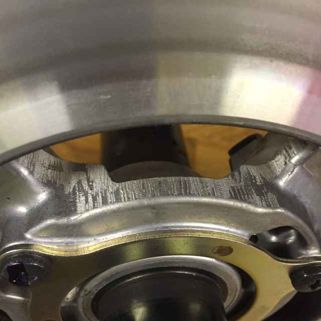

Here are 2 pics of aquaticlaker's primary clutch before cleaning. Notice the belt residue by the sliders on the spider. This is actually less than most I see, I've seen some that you don't even see the aluminum. His sled has run the 8DN belt since brand new, but because his secondary was binding up and not shifting open enough from the casting flash, his belt was slipping and causing his clutching to do crazy stuff. This was why his COTC setup was hitting the rev limiter no matter how much weight (rivets) we put in his primary weights.
OK, back to the primary..... Look for evidence of large amounts of powder from the belt, if its in your bellypan....it's stuck in your clutching also. I know for a fact that aquaticlaker cleaned his clutches a couple times and still had problems with engagement, hitting the rev limiter all the time and couldn't pull anymore mph no matter what we did to the clutching. This is with over 2,000 miles on the sled.

4) when putting the primary back together, look for the "x" inside the cover and on the spider, they must match up as this is how the clutch was machined so you want it back that way for balancing.

Clutches are coming in from owners with Vipers. Receiving 1-2 sets of clutches everyday now and can't believe the flash issues and sticking problems due to poor deburring.
