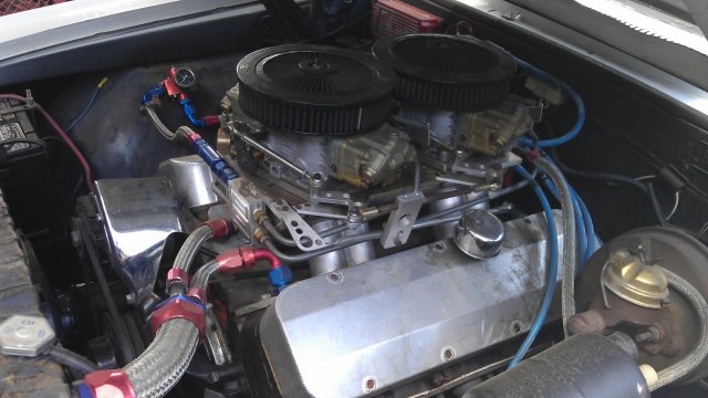

Know how you feel X3. Friend and I had a 64 GTO with a 427 Chevy with tunnel ram & dual 780 Holley double pumpers. Until we had a starter hand wound by a local expert we put a new starter in every weekend. 12.5:1 compression will do that! Had a rock crusher trans with a Borg & Beck 4300 lb. double diaphragm clutch. Spinning a 4:56 rear end.
One seat, battery in trunk, and green metal flake. Used to shake the houses when we started it while tuning it at home. Used to make test runs (200-300 ft) on the street in front of the house almost weekly on the East Side of Detroit. That would have been 1970-71.
Things were simpler then, never had the police show, all the neighborhood kids came out to watch the mayhem! Oh yea, and a couple of the parents. Open headers really woke things up!
This 427
