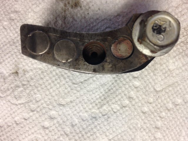

Weights are in, comparison pics below.
8GL with bump ground off heel on top of OSP below
OSP on top of stock 8FP below
stingray719
OSP on first look does have a steeper ramp than 8FP but the OSP weight body is different so in my opinion it is going to take real world testing to see how much difference there is.
Here is D&D/Magnaforce vs OSP
