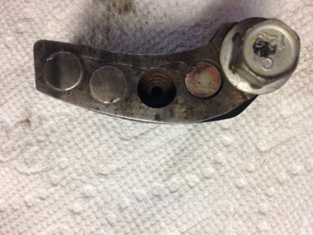

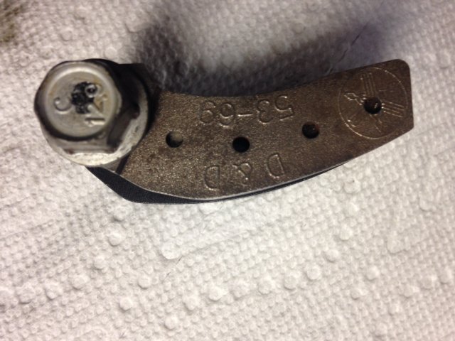

The D&D is flatter except at heel. But man that 8fp is beefy at end! Look where most of my wieght ended up. Tip holes are full.

Is this 1-0-3-3 or 2-0-3-3?
2-0-3-3

2-0-3-3
63.4 grams, you're making real good power to be throwing weight like that with such aggressive weights, your hard work and mods has certainly paid off.
That's with the 25-45 gearing. Bit low. 9050 last ride. Clutches nowhere near maxed. Was at 9100 with 2-1-3-3 and stock gearing clutches both maxed. Still need a bit more. But thanks. Those weights really allowed me to try different things without spending hrs tuning clutching. I will never run anything other than magnets ever again.Never would have tried them if you wouldn't have sent them. Now will try the OSP and see63.4 grams, you're making real good power to be throwing weight like that with such aggressive weights, your hard work and mods has certainly paid off.
