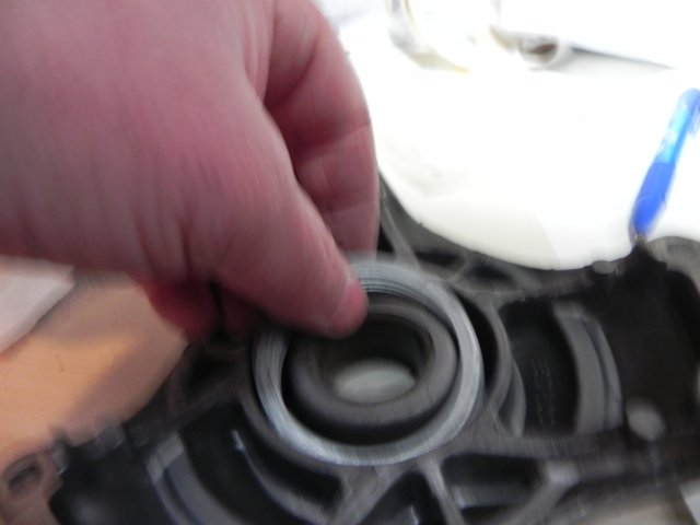

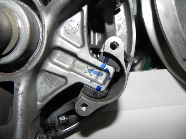

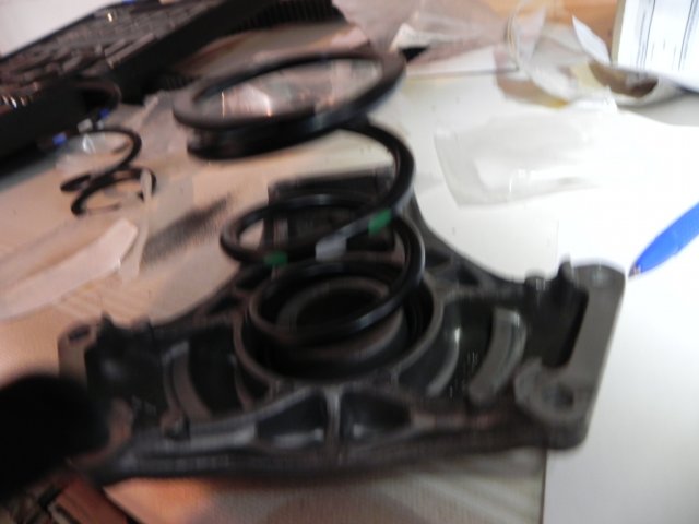

Okay here is a step by step installation of stingray"s cotc kit
this was my first time ever doing any mods to a sled it was pretty simple to install!
To keep thing as accurate as possible if you experienced guys see any mistakes please let me know so I can edit!
First I removed the side panels, seat, the black plastic cover that wraps around the gas tank and removed the belt(note: the removal of the seat and black plastic cover that wraps around the gas tank is optional I liked the extra room)
Second I took the primary clutch cover off by removing the 6 bolts(10mm socket)
Be careful there is pressure from the spring I just kept one hand on the cover to remove the bolts
3- remove 1 weight at a time
place something under the clutch to catch any parts that you may drop accidentally
remove the clutch weight bolt( 10mm socket 1/4 inch drive with a universal and 10mm wrench)
then loosen the 2 allen head set screws that hold the pin(2.5mm allen wrench)
slowly remove the pin holding the weight and the white washer on each side of the weight
4-Grab your new weight (I installed the 3.6g rivet at the tip) and install it making sure 1 white washer is on each side
center the pin tighten the set screws and install the bolt(torque@ 4.3ft/lb)
do the same for the other 2 weights
5 I installed 4mm shims in my clutch cover and a new spring
6- Reinstall the clutch cover make sure you line up the x on the cover with the x on the clutch (balance) and install cover(torque the 6 bolts@ 10ft/lb)
