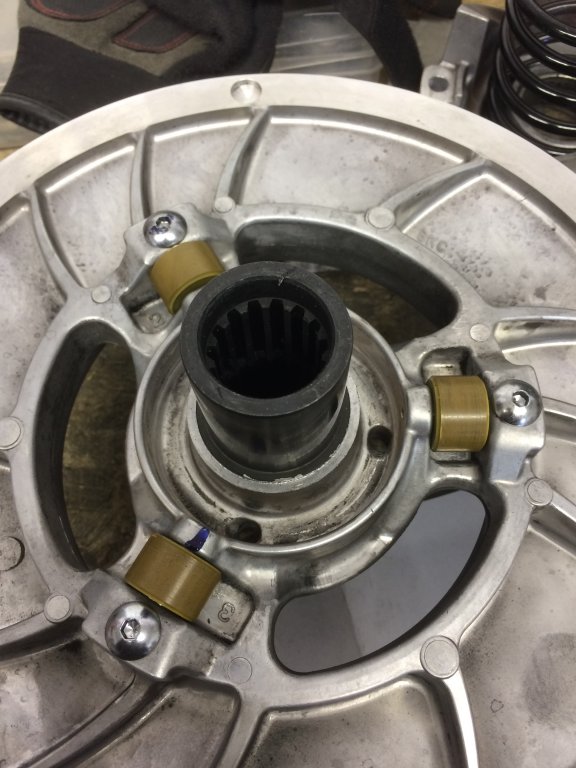

Thank you,that is great info,why in GODS name would Yamaha say not covered,its there brand new clutch set up,are they trying to pull a fast one,and I am trying to get them to replace my parts for a crashed sled?Is there others whit that issue.mine have 200km and have a flat spot on a roller.yamaha say not cover.and back order for at least 3 weeks.i just saisd forget it and get 3 rollers from a 2015 cat driven and it fit there and work good so,have to let you know if you're in the same boat.the rollers have the same over all diameter,width,and center hole too.

Well put 50 miles on the new rollers took the helix out and they still look perfect. Will know more next week going on a trip and will put a bunch more miles on and I will see what happens.View attachment 124343 I hope this is the answer out testing now.

theres two versions of the same part number...what did you use jon and ernie....regular or torlon?

Torlon. I used the ones I had a link to on this post. Got them today. Going on a week trip to cabin in the UP. Should have a good idea if they are good or not. Here you go SJtheres two versions of the same part number...what did you use jon and ernie....regular or torlon?

went out today for 100mls run whit cat rollers and they run perfect,now ,going to give a try to dalton ramps.

This seems to be the number one issue with SW.
It's gotta be material issue if the cat rollers last.
Come on Yamaha ! Catch up and fix this !

Looks like the Lenco roller cover I had on my ZRT8 back in the day. 8k+ miles on that cover and zero issues. The rollers in that cover were super hard and had a needle bearing on the pin. Firm believer in the bearing and pin setup over simply letting the roller revolve around the pin.Here is your solution....View attachment 124332

Some of the best clutching from CAT was that three roller cover on the secondary!Looks like the Lenco roller cover I had on my ZRT8 back in the day. 8k+ miles on that cover and zero issues. The rollers in that cover were super hard and had a needle bearing on the pin. Firm believer in the bearing and pin setup over simply letting the roller revolve around the pin.
