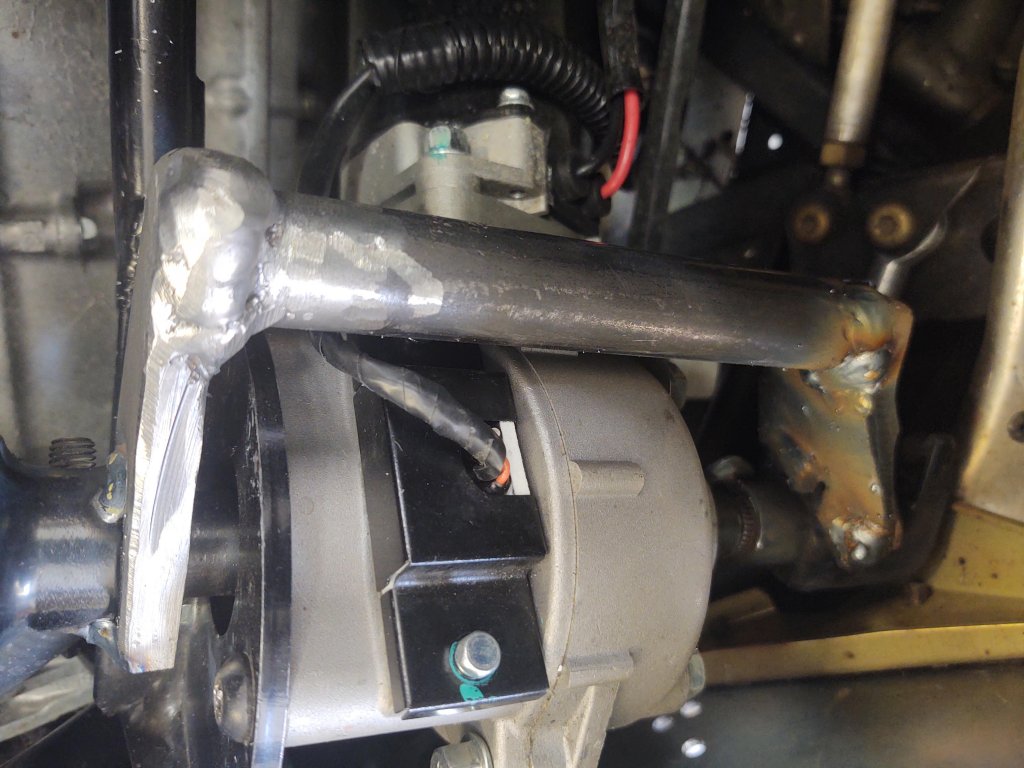

I decided to try this this season for a few reasons 1) I'm now running a 137 AC RR instead of a 129 and it's harder to turn 2) I run curve skis with thrusters for super aggressive cornering, and 3) I'm getting to old to wrestle this 4 stroke monster on back to back 200 mile+ days.
https://www.gseperformance.com/prod...-yamaha-sidewinder-and-arctic-cat-thundercat/
The install took about 3 hours. It was very straight forward and great quality. Everything lined up well with no finessing required. The kit weighs 13lbs more than stock, but I saved that much with a EarthX battery. The weight is relatively low so I would say it's unnoticeable. I did wire mine up with an on/off rocker switch on the handlebar, but I'm going to eliminate that soon.

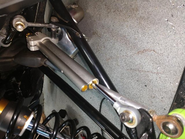

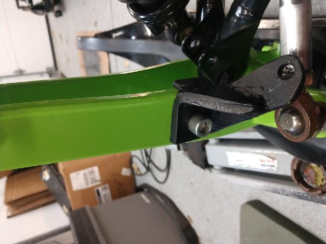

Over all, it's amazing. Makes the sled feel like a 2 stroke in the twisties. When I first rode it in warm weather on rutted trails, I did notice that the sled was more sensitive to "wandering" at high speeds on such snow. This is because there is "play" in steering shaft through the motor which allows the switch mechanism inside the motor to do it's thing. As a result the ski's can turn a bit while the bars are held straight. I notice this is worse with the power steering turned off. To help with this situation, I decided to mount a custom Ohlins motorcycle Steering Dampener between the spindle and the A-arm sway bar mount. This helps introduce some resistance to control the play. Once I did this, the wandering problem was 90% eliminated. Or the condition changed such that I didn't notice the problem...I can't be sure which.
https://www.amazon.com/Ohlins-Steering-Damper-Sd-003/dp/B00AIDZXTC

As a follow-up, I've figure out that I love it on hard pack, but not so much in loose or fresh snow. It's a tough trade off, most of my days have been the former, but when it's in loose snow that "play" in the bars is tough to get used to. But the rest of the time it's incredible

Update for 2020...Covid got me thinking, what about having a power steering "lock out" when you don't want it, such that the steering shaft is "solid" vs having the play when you don't need it?
I have a video to explain it better but I can't load it because it is too big

Links that show the function:

Well thought I'd update on this as now it comes stock on the new 22's. My set up with the steering slope bypass is working very well after a single hiccup (I was stroking the solenoid past its recommended max causing it to burnout - all fixed now). I can say that about 75% of the time I ride with it off, as I'm at speed or on straight trails and it's not needed. But when I get in the woods, on she goes and the sled is transformed to a sled that's easier to handle than my XCR 850. I can drive it faster through the woods than that XCR. So the idea that it's not a performance feature is misguided in my view. It absolutely adds to the speed when the trails get twisty, at least for me. All this said, it would be great getting this from the factory as I said earlier.
