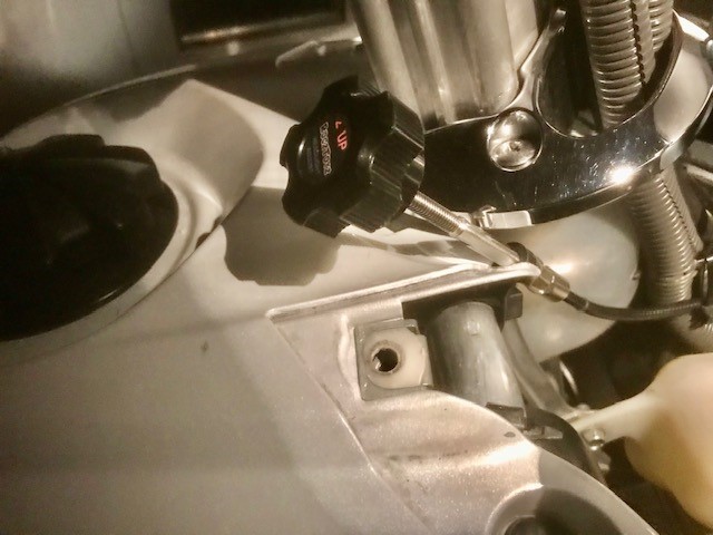

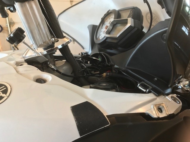

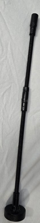

This has been done before. This is my version of the mod.
Here is a quick and easy mod for a remote headlight adjuster.
Parts needed:
JB Weld or similar epoxy
Black can of Plastic Dip
10mm socket
12"or longer flex extension 1/4 0r 3/8 will do. Shown here are two 8" extensions JB'd together
Thumb ratchet again 1/4 or 3/8
Small hose clamp
Steps:
Attach thumb ratchet to extension. Dip this end into Plastic Dip and then let dry. I find multi coats works the best. This will do a few things. 1. It will secure the connection between the two 2. Stop the thumb ratchet from ratcheting 3. Makes it look good.
Clean the 10mm socket and headlight adjustment bolt. Brake clean or acetone works well.
JB Weld the socket to the bolt. Let the epoxy set up over night.
Feed the flex extension thru the steering ring and lower loop on the column.
Pop the extension into the socket.
Mock up hose clamp to the lower loop and extension. Make notice where the clamp makes contact with the liner of the flex extension. Remove the extension and cut the liner so it can rotate freely when clamped.
Reinsert the extension and connect to the socket. Install the clamp. Tight enough to hold the extension in place but loose enough to allow it to rotate.

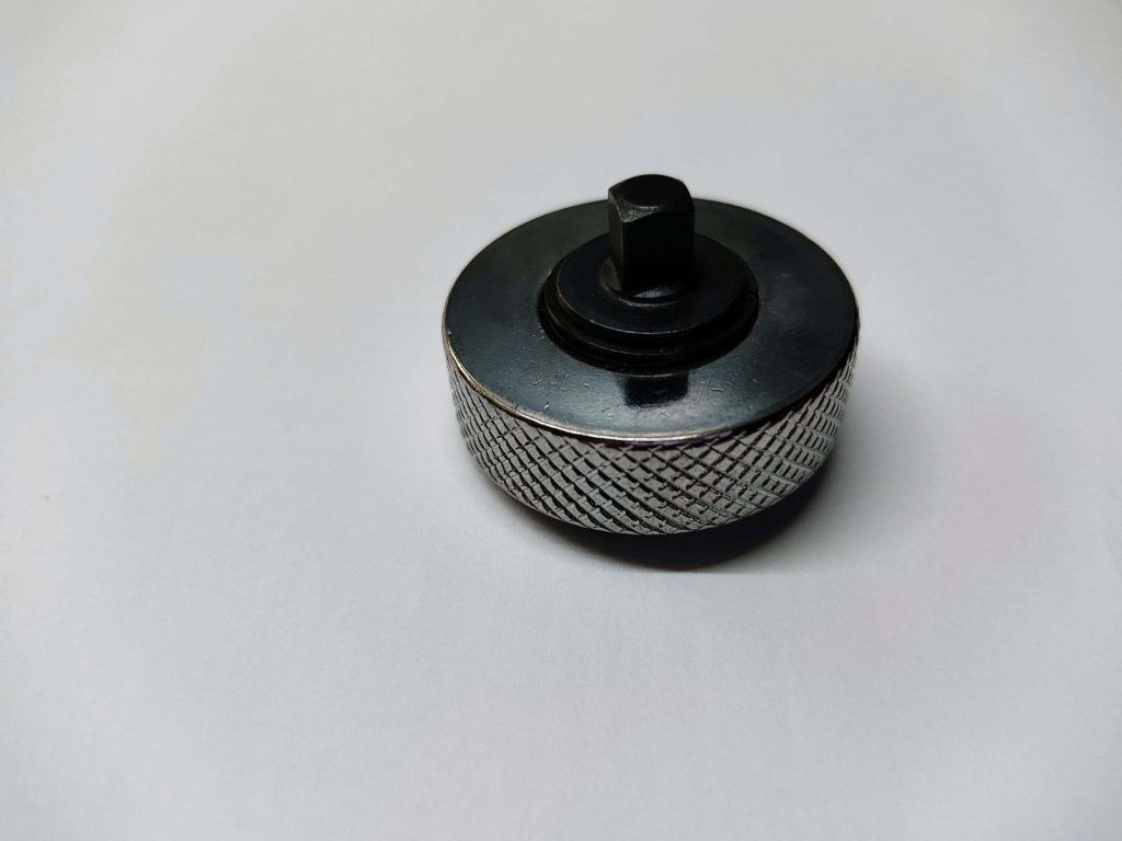

Looks good and will certainly do the job. Whether or not that's the case as your cruising down the trail with gloves on and want to adjust.
That was always my concern with that thumb ratchet. How well would I be able to turn it to adjust? Either way, an inexpensive way to adjust your headlights without having to disassemble everything.
JG231-
- Nov 1, 2024
- 29
- 168
- N. Michigan
- 07 Attak
It turns super easy, It's a heavy piece of metal and it only takes about .5 ft lbs of force to turn the adjuster, Worst case scenario I could take the metal cut off wheel and the Dremel and I could cut a few knurls into it for grip but the preliminary tests seem to indicate that it'll work good .Looks good and will certainly do the job. Whether or not that's the case as your cruising down the trail with gloves on and want to adjust.
That was always my concern with that thumb ratchet. How well would I be able to turn it to adjust? Either way, an inexpensive way to adjust your headlights without having to disassemble everything.![]()
I should've actually taken the time to set the ratchet into the vice and done a proper job on the tack welds, cause thats gonna bug the hell out of me forever now lol.... I actually spent 11 bucks and got two of each size ratchets (1/4 3/8 & 1/2)...... I could redo it but honestly it works and it really looks worse in the pic than in real life.......
It just pains me how much money I spend in a month and if I can save a few bucks here and there I will..... Not counting the labor or the paint this is about a 14 dollar part......
