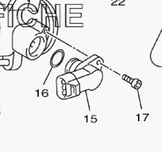

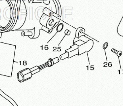

Old Thumper
Well at least there is a difference. Must be a pretty impressive wire for an additional $47From the parts diagrams, the newer one has a wire whereas the 07 version has just a plug. And an additional part #25 on the newer one. Looks like the throttle body changed.
View attachment 147773 View attachment 147774
Similar sensor for my '08 Nytro is only $72...
