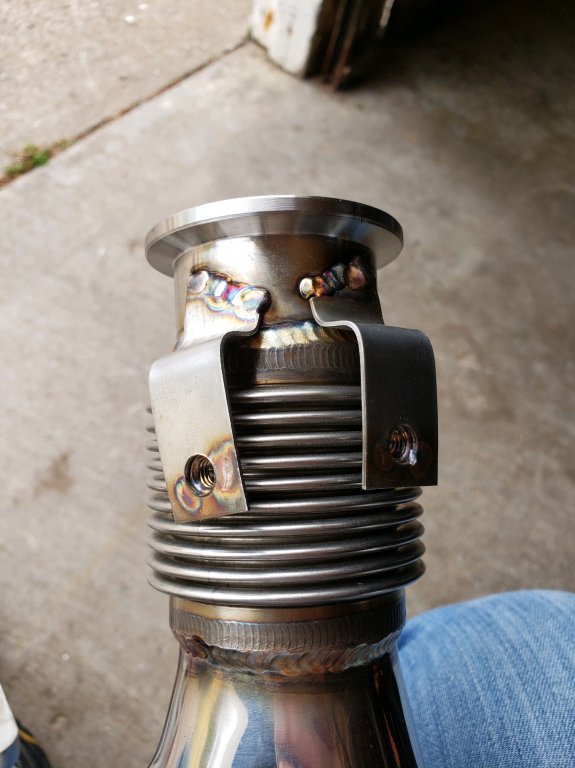

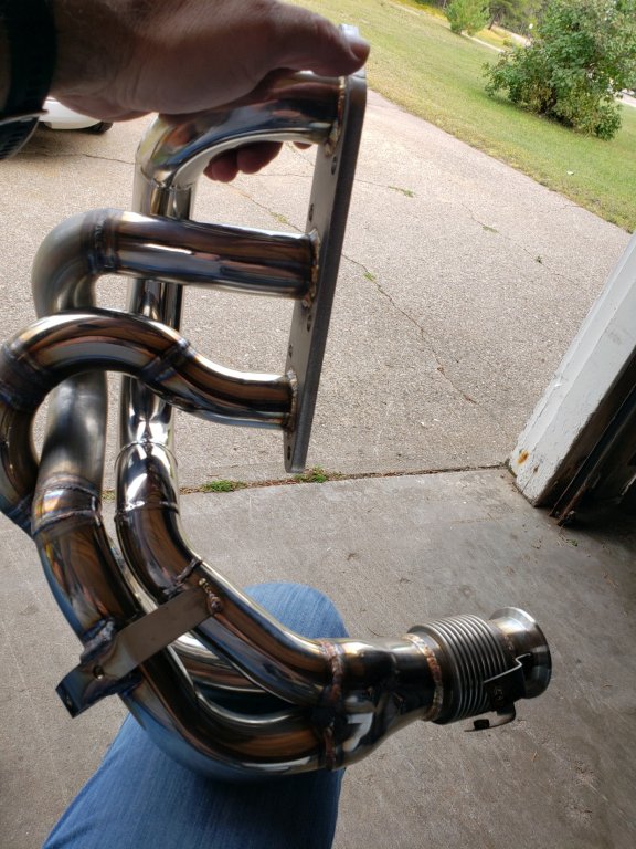

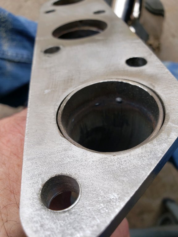

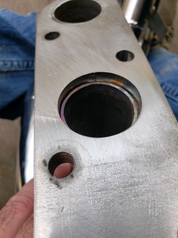

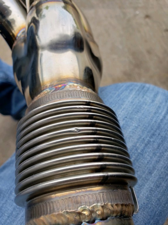

Check out the Hurricane header I received. Dented, brackets misaligned, flat flange still has rolled edge on it from drilling, pipes half finished, pipes not even in the flange.
I sure hope I dont have to buy a different steering support.
Must have slipped thru some how...
View attachment 156906 View attachment 156907 View attachment 156908 View attachment 156909 View attachment 156910

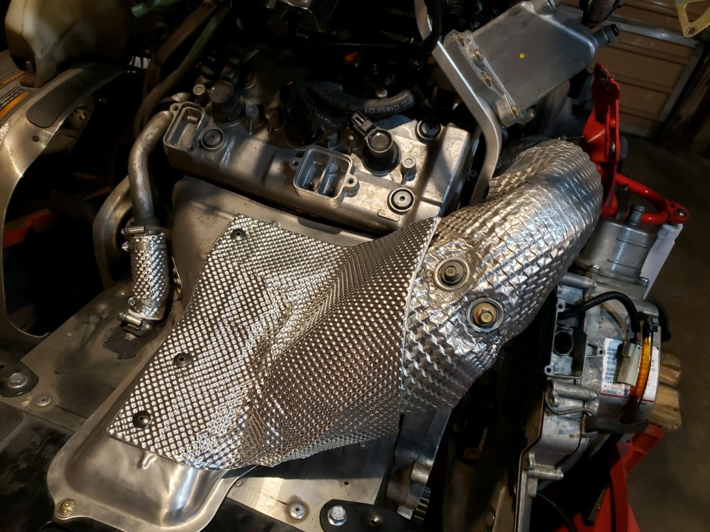

Heat shields on updated header.
I like it!
I like it!
I bought the updated header as well. Did that additional heat shield come with yours?
I called Dave and he sent it to me. He said it's supposed to come with the header. Plus another smaller one for the coolant hoses.
