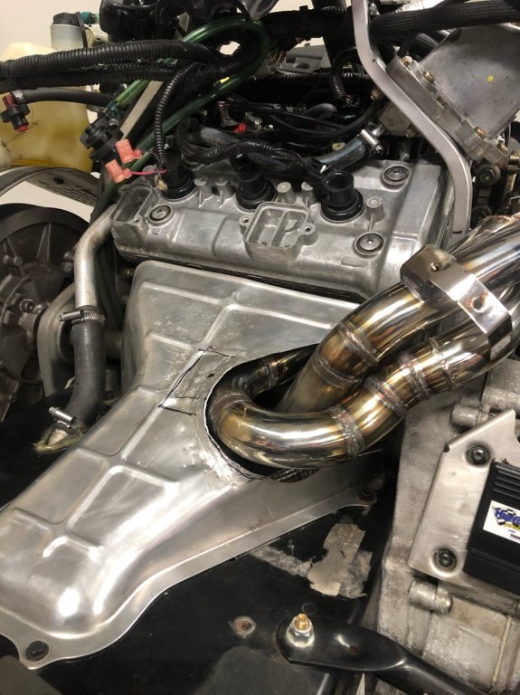

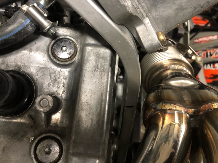

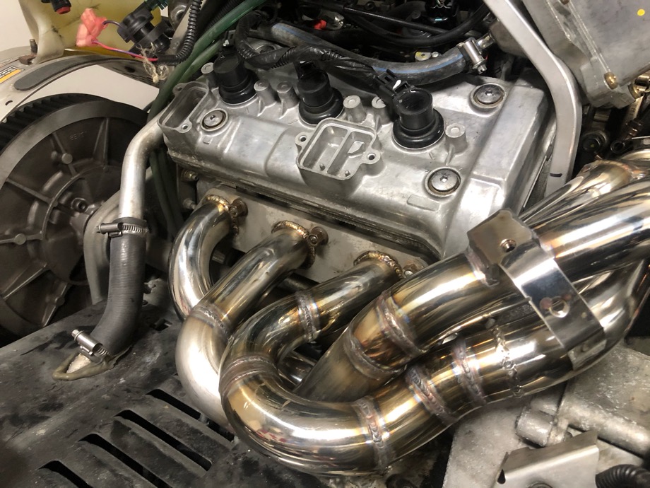

View attachment 157099 View attachment 157100 View attachment 157101 View attachment 157102 View attachment 157103 A little tweaking and fits mint all kinds of clearance with factory bracket and gas tank
View attachment 157100 View attachment 157099 View attachment 157103
View attachment 157099 View attachment 157101 View attachment 157102
Finished product ready for tank thanks Hurricane Dave
Very impressive Pan just like all the work you do buddy!!!
install looks oem !!!!
