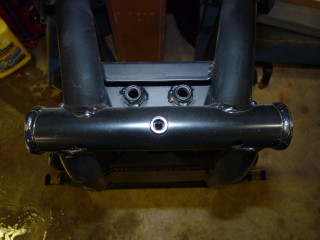

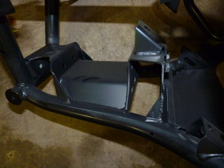

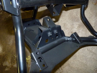

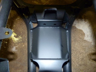

I bent 2 frames before I smartened up and put in grizz's gusset kit. No problems since.
The first time I bent it I noticed a drastic difference in the handling.
