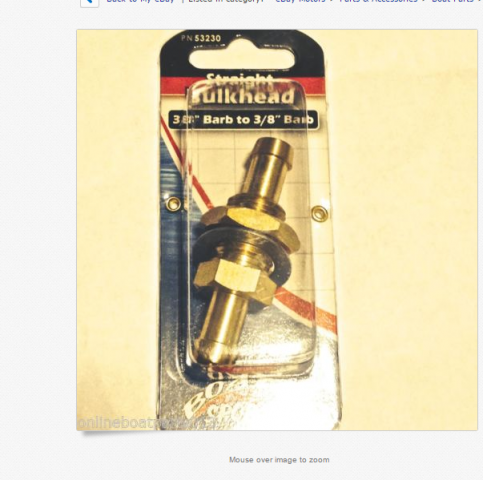

Hey Rxrider I need to plumb a external fuel pump to make this work the way I want, did those ski doo rubber nipple seals actually work for you? man I don't like just drilling a hole at the bottom of the tank, popping it in and calling it a day! I'm thinking more of a marine based bulkhead fitting out of brass that has a nipple on each side to seal my connection on the tank.

There is no leakage With the Ski-Doo fuel tanks, nothing at all.
If you're running a aluminum fuel tank the coupler in the pic is the best choise.
Plastics and rubber swell up in contact With gasoline thus making a tight seal With no leakage.

Ok I'll run the ski doo grommets then. Thanks!
