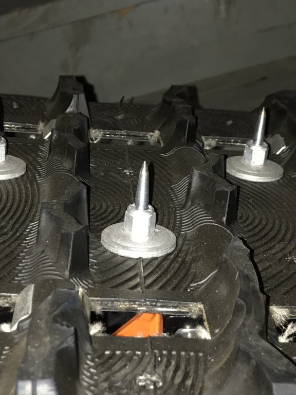

144 1.5" in the middle , yamaha tunnel protectors.I am reviving this old thread rather than starting a new one. I am about to pull the trigger on trading my 2015 SR Viper RTX DX in on a 2017 Sidewinder LTX DX. I am also thinking about adding the 270 HP Turbo Dynamics kit.
1) How many "panels " (areas between the lugs where the studs mount) are there on this 137" track?
2) How many studs should I run if I only utilize the middle section of the track? (I have had bad luck in the past with pull outs when I studded the outsides)
3) What length studs should I run? (I ran 1.375" Fast Trac Top Gun II 's on my RTX DX Viper which worked well).
4) Should I avoid the "quiet track" raised pads so that the stud heads pull down completely flush? (I noticed this issue when I studded my Viper)
5) Do I need heat exchanger protectors?
Thanks in advance guys for your help!

Get the pattern tool from Bruce at cb performance.... take some tape to the template and block off holes number 6? To the center on each side ... about 3.5"... stud every outside varying between the holes available.... and varying the inside .. so 1 and 1 then next row 2 and 2 etc .... use a fine tipped white out pen.... this will all make sense when you have the pattern tool in your hands...

Tear outs has as much to do with too long of stud as it does quantity, and for that matter the quality of the base you ride on....I agree more penetration kicks butt for hook, but for trail riding when you start running over 1.450, you are asking for PUSH on hard trails, and more tearouts, and the outers are more vulnerable to tearouts and increase push on twistys.
Running the radar track in NB vs drag racing in fields, vs trail riding tight trails...Guys reading this who are novice need to understand that you really need to ask yourself what type of riding you do MOST, and what do you want from your sled. Prioritize your needs too. Then take all this good info on here and you should get your answer.
You can see this any weekend when a trail studded sled is brought to the track, and watch him barely hookup at take off...I would want a totally different stud to run NB track, vs what I run on trail. As Saber showed, the trigger(or other lake/ice stud) is what you want for serious penetration on ice. But I can guarantee you that design wont be the best bang for buck on longevity and remaining sharp on trail riding. Its all about what you want out of your sled.

Ive run right around 200 of the longest studs allowable per chassis...and have corner burned with the best of them....and havent had a tear out in over 25 years...and in some cases like my 2011 z1 turbo BOOSTED the first 400 miles were lake racing.....pull outs come from under capture on the track matt (deflection) and under studding...some brands of studs are more prone to this because of the higher shoulder (woodys)

Tear outs for me have to do with early and late year trails mostly! If one can wait until the trails are frozen
and they have a good base, well chances are much better of retaining all studs in your track. So yes agree 100% “Quality of the base you ride on” and length. Deeper paddle on track = longer studs!!!
Have you ever Seen a stud stuck in a tree root that crosses the trail during low snow conditions. Much like driving a nail in a tree, it wants to stay put, it may come out or it may stay put and pull through. I have seen them and thought, O boy somebody just harmed a track, and then again I have been on that end many times myself. Even if it just tears instead of pulling through, first WOT run and tic tic tic boom. Very easy to check your track while loading in trailer, I do it every time I load when I run studs to stay ahead of tears and pull thru. Just can’t wait for perfect conditions around my area.
