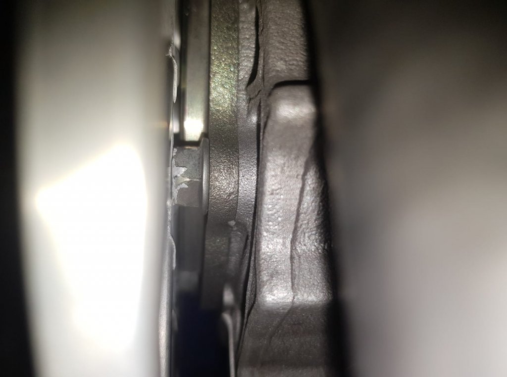

Before checking your offset, make sure you all are checking to see if your snub shaft pushed in. This has happened with a lot of belt blowers.
Take a mirror and look between the engine and your primary clutch. You should see a visual gap of a 1/16" between the heads of the bolts that hold your snub shaft block on the engine and your primary clutch.
A lot of these are coming in from belt blower Sidewinders and Thunder-Cat. This majorly changes the offset distance.
"The fix" The primary clutch must be removed and the housing block that holds the snub shaft can be removed with a bolt and slide hammer. Once removed, the snub shaft needs to be pressed out, cleaned and re-installed with green loctite, pressing the snub shaft back in. (Note, never rotate clutch clockwise while mounted to engine. It could possibly just timing because of the hydraulic timing chain adjuster.)
View attachment 154251 View attachment 154252 View attachment 154253 View attachment 154254
mine had moved almost 3mm whitout touching the back of the clutch .
Green locktight OD AND ID....
57:5/58:5 offset should put you in the ballpark

Byam, do you have any pictures after you redid the bearing? Cause I have a .040 gap on mine.mine had moved almost 3mm whitout touching the back of the clutch .
