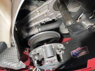

Well I found 1 of my problems one of the rollers in secondary has deep flat spot also looking a few thing over primary sheaves looked like they smashed together is this something I should be worried about or can I just clean it up and be fine.
When you blew belt, the two sheaves hit together causing that. If they hit hard enough and/or frequent enough it can crack the sheaves sometimes. Clean that area up with steelwool and if no visible cracks you are Ok.
Better check yer offset, your stub shaft might have moved.
