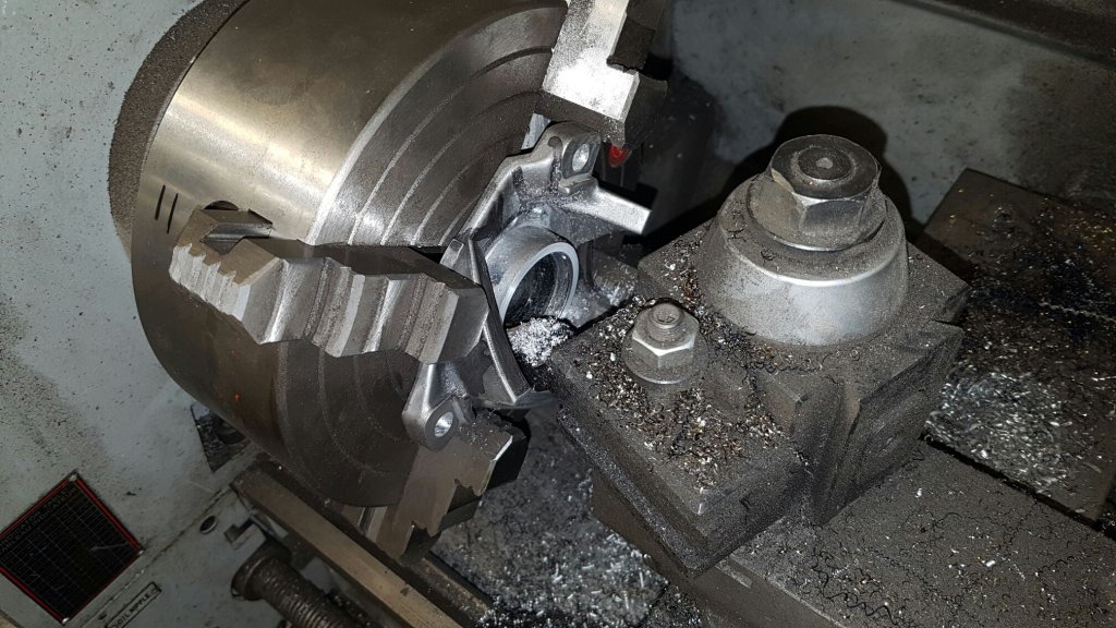

When we machine the primary clutch can anyone explain or show picts how much is being taken off and how high their belt rides now. With my low gearing on my xtx and my engine mods i can use the extra shift now. I already cut down my secondary helix to allow it to move fully open. I believe with the 8dn belt and having my secondary open more i am close to a 1 to 1 ratio. I believe befor i was not getting a full 1 to 1.

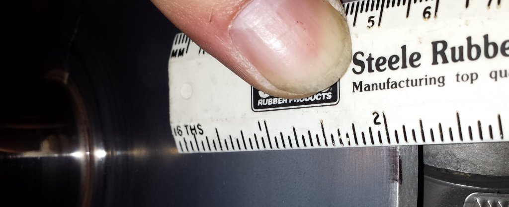

This is on my Viper running the 8DN length belt. As you can see, the mark is .062" or 1/16"
****** This is a reminder that machining a clutch for overdrive must be taken very seriously and will void your clutch warranty******
You can machine .020-.025" (straight cut) off of each primary face at the bottom next to the main steel shaft.

That is a good picture..smart test to..nice jig...
Notice your belt tracks on the secondary..you are pretty well at the bottom of the secondary as it is.
I would recommend 1:1 and let your gearing do that speed work..

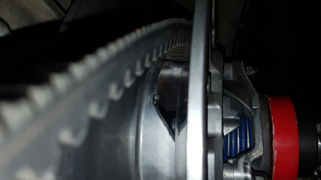

How are you avoiding secondary coil bind with this setup or do you have some coil bind?

Ya i can now b at the bottom with my 8dn belt and cutting a little off my secondary has allowed me to be there. With this as it shows on my marks i can travel down a 1/16 or so in my secondary to take full advatage of my clutch face. Befor it was not that low in the secondary. Now i can get a little more from my primary and will cut a little bit off it to do so. It will not be much but every little bit on both faces is a lot of extra shift ratio. Im not shooting for crazy speed just wnat to take full advantage of my clutch faces and shift ratio. As i said befor i dont think i was at a 1 to 1 full shift.

No spring bind that i can tell. You can see the spring on right side in pix.How are you avoiding secondary coil bind with this setup or do you have some coil bind?

Oh ya and i also hav a blue secondary spring from big venum ckutch kit. Im shure my stock would be binding.

Also the best part of the 8dn belt is that you can ride so high in the secondary allowing a very low ratio for starting.
