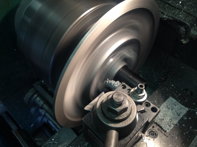

View attachment 100812 Machining the spring pocket a bit deeper to eliminate coil bind.
Nothing like a pic!

By doing what's shown there will eliminate the coil binding, but does that allow for full shift of the secondary? From what I've seen many guys are still saying they machine sheaves yet too to reach full shift

No, a stock helix can still limit full shift if the primary has been machined for O/D.By doing what's shown there will eliminate the coil binding, but does that allow for full shift of the secondary? From what I've seen many guys are still saying they machine sheaves yet too to reach full shift
