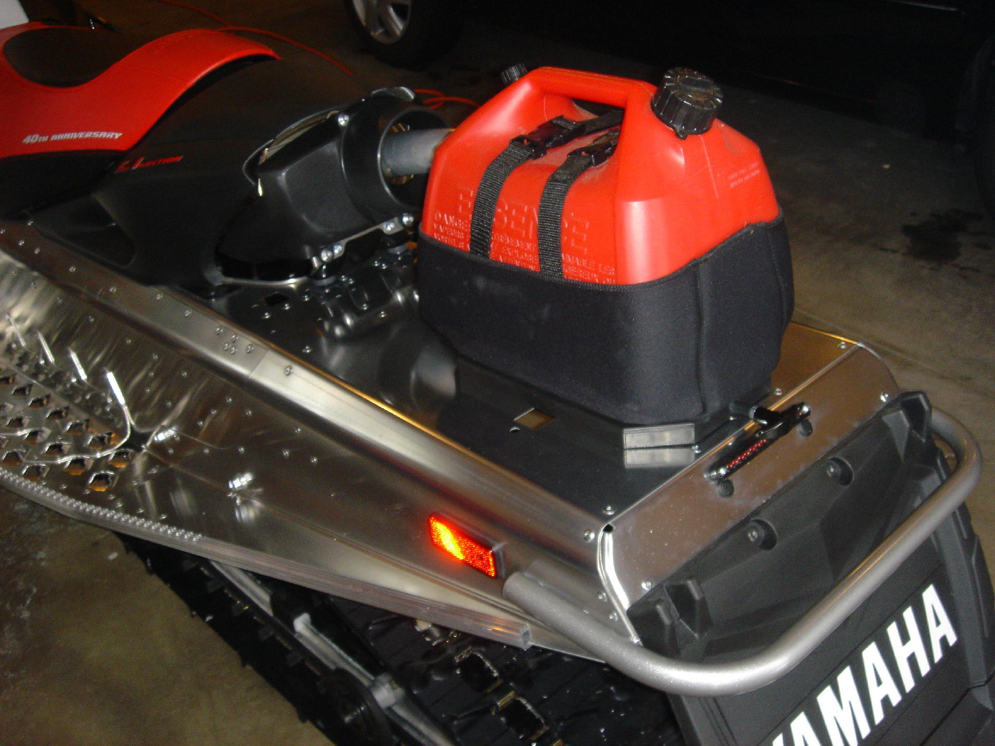

I started the project tonight. I will post pics once complete. I am using the Craigger Built system from from old sled like spray25....awesome design.
Unlike spray, I'm removing the tail light and mounting an LED on the rear were there reflector was located.
My plan is to do that too. I am turning it front to back nad moving it over so I can have a bag too. In the pics it is just setting there cause I don't want to bolt it down until the bag and light are here.
Bodacious
Mounting the new LED in place of the reflector seems like a good location but, the LED's don't make much heat and because of the snow that will collect above the snowflap I would think it would become invisable in a short while.
Here's mine. I used the Craiggerbuilt system from my old sled. It works awesome cuz you can remove the tank in a second. What do guys you think?
spray25
Looks great!! Which LED light is that?

Yellowknife inspired me to look closer at the stock tail light. I am now going to relocate it in a similar way to what he did. That saves some $$$.
spray25
I finaly got around to mounting my bag and gas can. I was able to re-use the OEM light and kept the wires out of the tunnel.

spray25
FYI the holes left by removing the rear reflector line up perfectly with the tail light. I did extend the wires. I put heat shrink on them and secured them with zip ties that are under the edge of the craigger built bracket. The tail light is at a bit of an angle but you can see it just fine and it kept me from having to buy a new light.

spray25
I have been running the above setup for sometime with good luck using the Yamaha turn out. I installed the same setup on the wife's sled using the Craigger turn-out and it does not turn out far enough. It melted her bag!!
