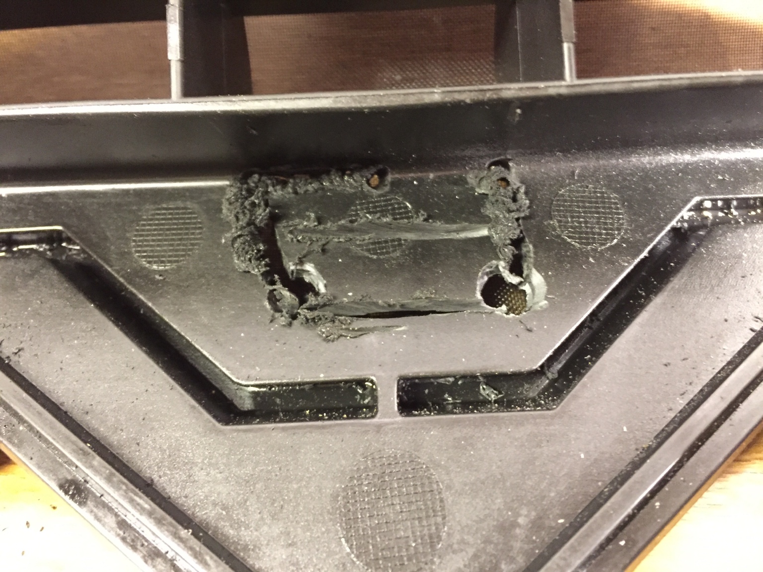

I decided to do the air box mod. I bought some tools I thought would be perfect for the job, a pneumatic drill which you can put on many different drill bits, etc. Kind of like Dremel, but running on air. However, using a cutting wheel wasn't working as the plastic on the air box melted when cutting...
And the cutting wheel was a bit fragile
I used a 5 and 10 mm drill bit to drill out some guide holes in the corners
Then used this "dentist" drill bit to cut out the rest. I found this to work the best (of the tools I had).
Once that was done I used a round sanding drill bit to smooth out the edges. I left the frogskin support in there
Lastly, heated up that divider and bent it over. The plastic on this air box didn't bent over easily and I had to heat it for quite bit.

GOOD JOB Looks good. How loud is the intake after these mods? Is it just a change of tone or is it a noticeable change in volume?

LOOKS GREAT! Good work!
stingray719
Yamadoo
I couldn't tell any difference in sound, but we all hear differently. Those that have done the nose only mod like this one notice any noise?

I haven't started her up yet so don't really know if there is any difference in sound. Hopefully it will add some punch to the mid range

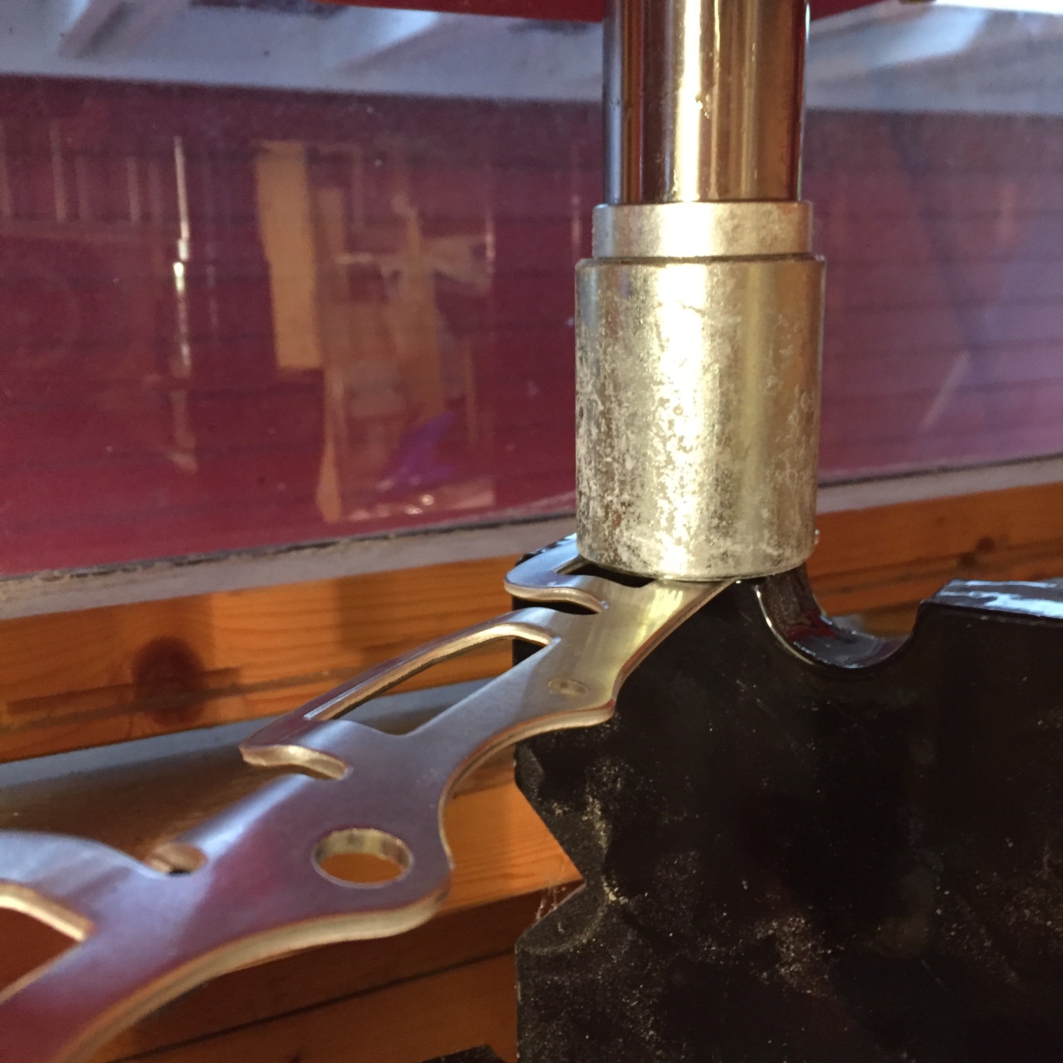

I figured out I wanted the possibility to strap stuff to the tunnel also when I'm not having the tunnel bag on, so I bought two Apex M-TX hooks.
They are stock tilted inwards so I had to straighten them out in order to fit with the tunnel bag
This is how they look stock
I have a 10 ton shop press which I used to straighten them out
A few coats of paint and riveted to the tunnel
I also took my grinder and rounded off the edges on the seat latch to prevent wear and tear on the tunnel bag. I also but a few rounds of tape, until I get some more useful to put on permanently
