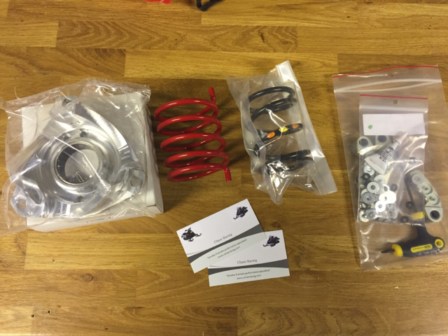

Got my Ulmer Racing clutch kit and Schmidt Bros Racing Quiet Shims kit today. Will install them over the weekend

Well, I couldn't wait so I went to the garage and installed the clutch kit, shim kit, 8DN belt, OSP Belt Adjuster and RAM GPS mount

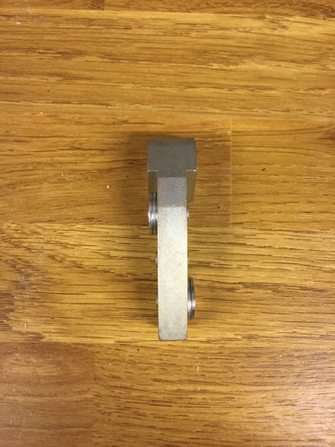

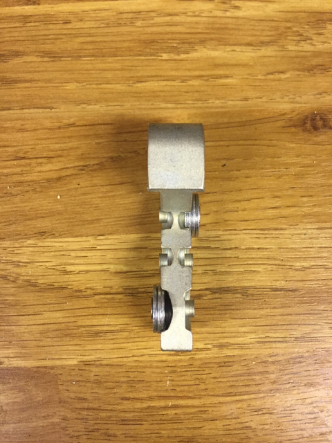

These are Ulmer Racing flyweights

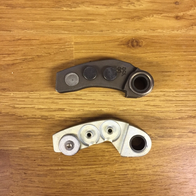

Stock vs Ulmer flyweights

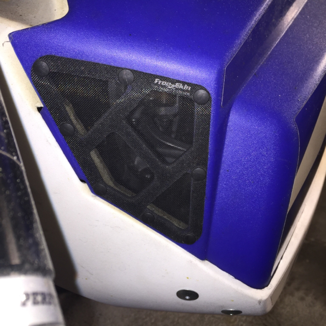

I have this on the left side panel in front of the clutches, is this vent there stock?

Yes that vent on the clutch side is stock
