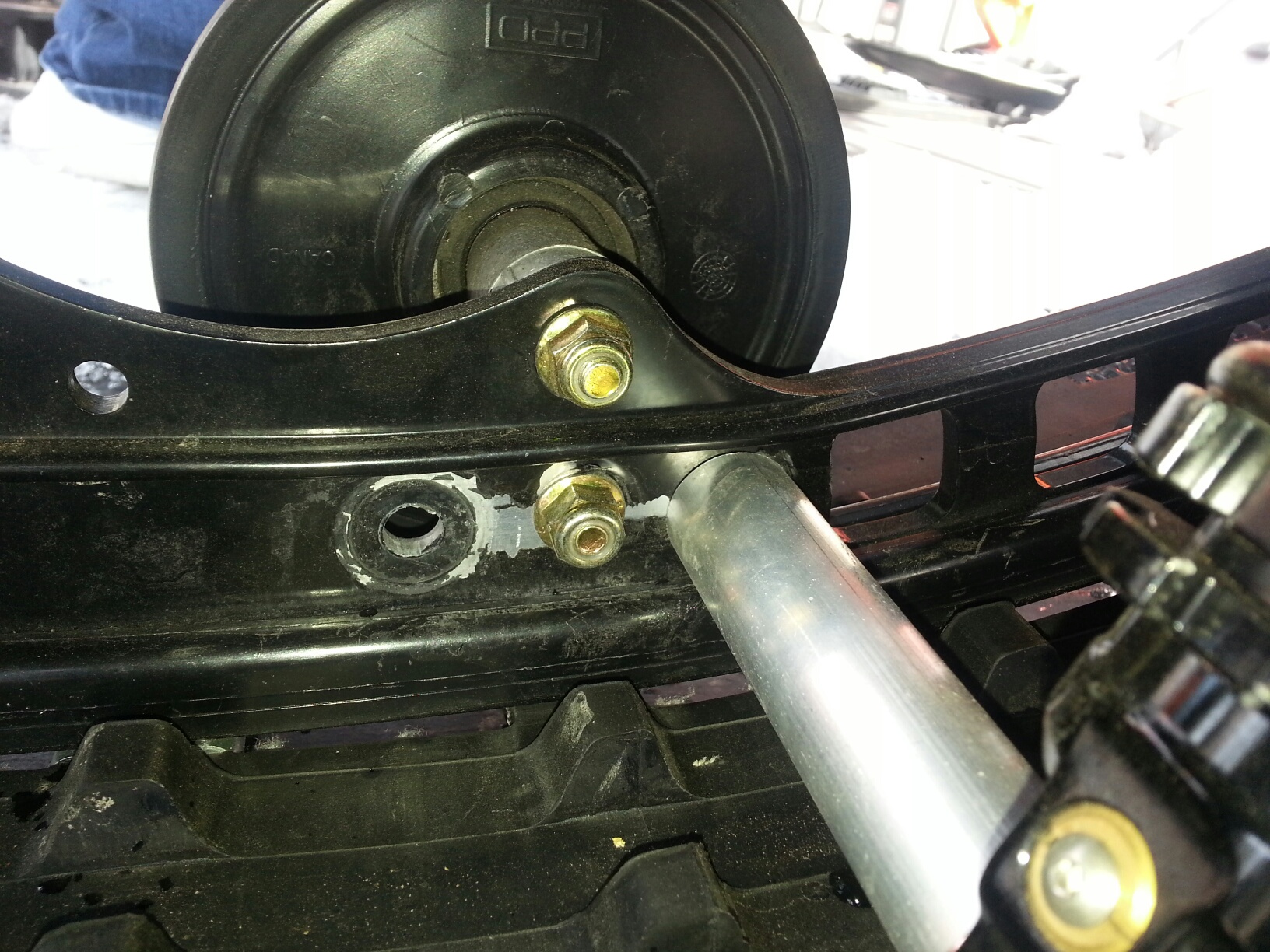

Is this essentially compressing the center shock more? Pictures of your new holes would be great as I can't quite visualize where your new holes are..my biggest concern would be wasting some of the shock travel but maybe that isn't the case. Pics would be great! Maybe the ltx is too much different than the xtx but may be worth a shot
This mod may help short tracks or may not, please tell me if it does. This mod on a short track would give better transfer but might make front too light.
You probably also noticed the shock spring is set on softest setting.

Studroes144 said:
I'm not looking at my sled right now and can't remember where the wheels are positioned..you basically just moved the shock roughly 1 inch close to the front of the skid?
Moved it the same distance in front of the wheel as it was behind the wheel.

Yes, 2014 M8 is the same skid as the 2014 Viper except length and front shock position. I long tracked mine and the lack of transfer I had from short track was worse after long tracking, ergo the skid shock relocation.
