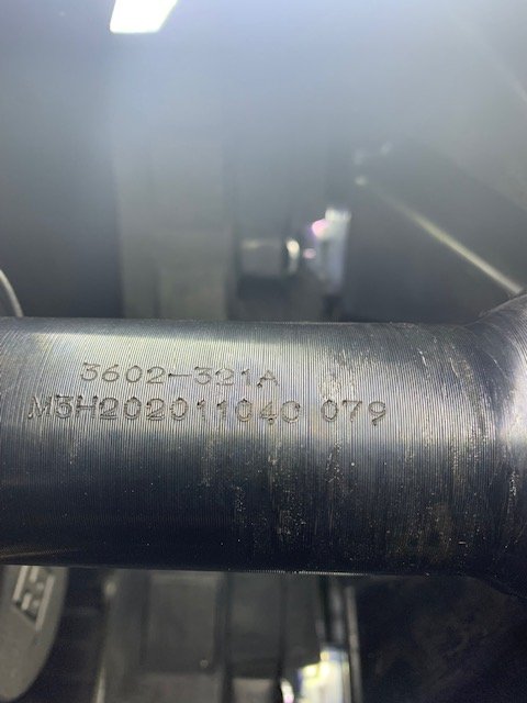

Wanted to bring this back to the top! So I have 2021 arctic cat 8000 that needs a shaft. So I look it up and this part number is what cones up. This part number 3602-321 is what replaced the shaft part number on the 2021 part list. And one in the same shaft that was installed at factory on the 2022 sidewinders. It now says this “new” shaft is no longer available?? WTF is going on here. I can’t even get a replacement shaft from Cat? Not even the “new improved” one?? I know BDX offers one. SO they have a new part number for the 2022 sleds that is “ no longer available “. Something is up?

Sounds like the new and improved version is getting improved.

Yea I put the old one in my cart at country cat and it says it was replaced and then when I agree to new part number it’s no longer available .
