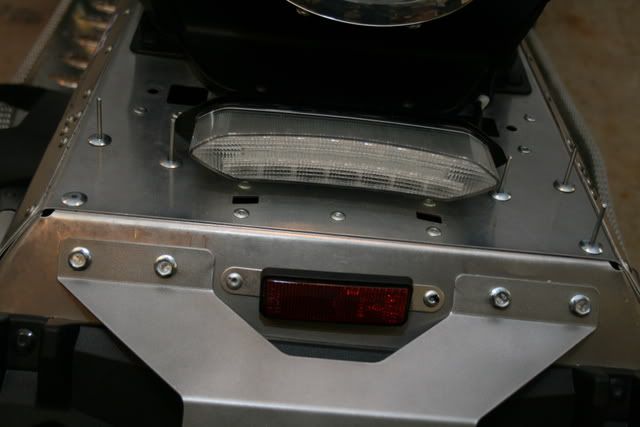

I bought this from Wiseman's Sales and Service in Clarenville. My dealer in St. John's told me the hitch for my machine wasn't released yet. Good thing you don't listen to every thing you hear. Thanks to TY member Coyote who posted he had one installed last year on his 08 Nytro.This hitch will prove quite useful for my trip in March to the Cabin. Very easy to install.
Remove 4 bolts that secure the stock bumper.
Install new Tow bumper using the same bolts just taken out. Use Loctite on bolts and tighten.
Now, use the 4 1/4" holes as a guide to drill through rear plate.

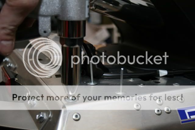

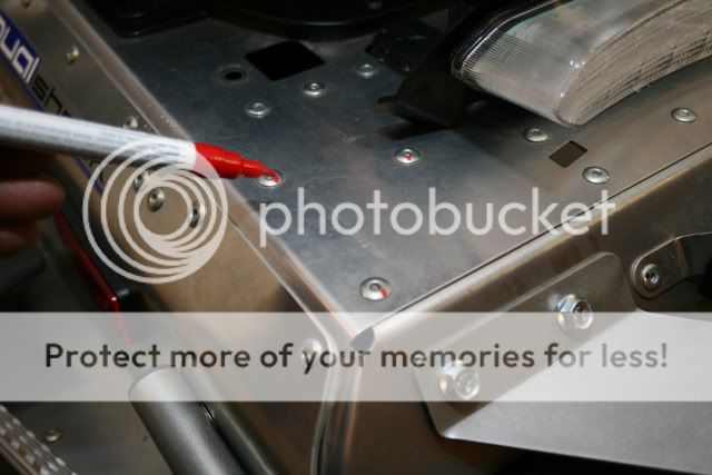

I put the tunnel re enforcement plate under and marked a line where it had to be placed. There are some rivets to drill out. 6 in total.
Put plate under and bolt on using the supplied hardware. Drill the six holes in re enforcement plate and get ready to rivet. I used heavy duty rivets, 5/8 head.
Before
After.
Now my Nytro can tow!![]()
