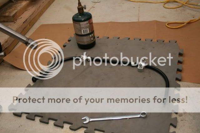

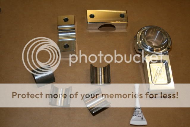

Thanks guys. Just wanted to update my thread with this mod I installed. I know a lot of people have already done this and had great success but just wanted to post it up anyway. Really looking forward to testing this out.
OFT Steering Relocator Kit
Machined from billet aluminum and 100% Oilite
Kit includes new UPPER AND LOWER bushings that will replace the wear prone OEM plastic bushings.
This is a fairly easy install and the instructions are well written for everyone. All you need is somewhere warm and a few tools and your set.
Here is the link for reference
http://OftRacing.com/Sled%20Products/Re ... ocator.pdf

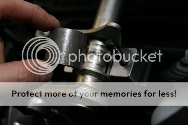

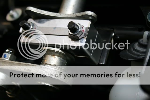

Here are a few pics from my install:

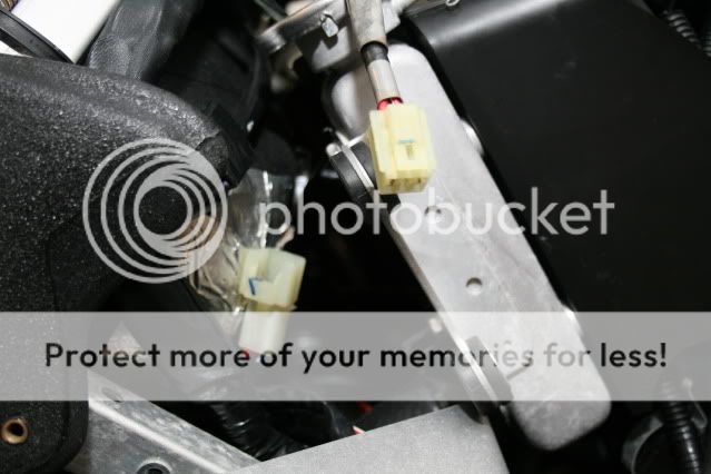

Had to remove this Rad bracket so I could unplug the ignition switch connector.

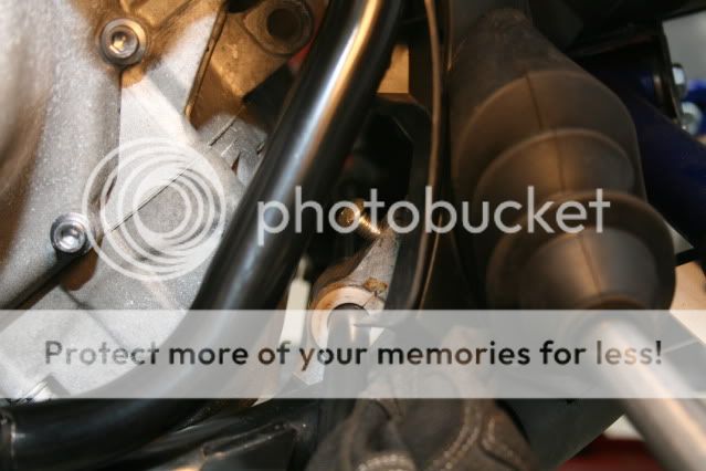

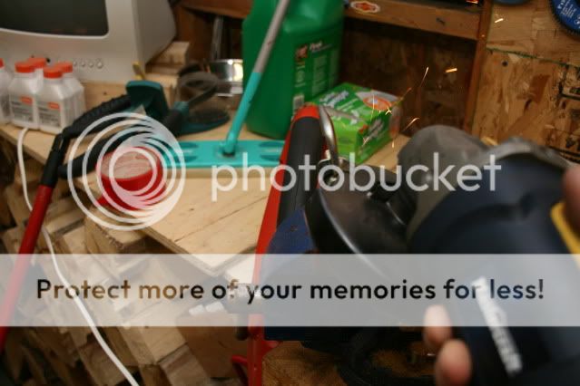

Trimming upper bearing retainer assembly. I used a zip cut. Worked good and filed off edges.

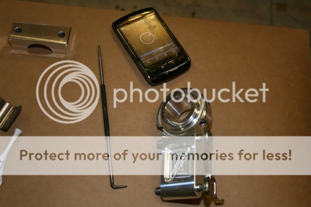

Pic of the new steering block on bottom and Olite bushing.
This is a top notch product, can't wait to test it out.

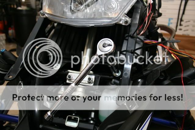

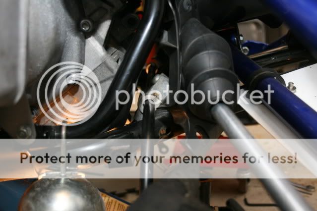

SWAY BAR REMOVAL ON NYTRO

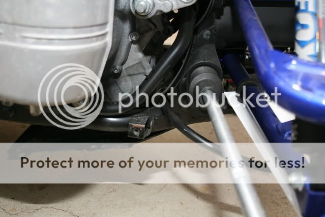

Here is a pic of sway bar removed. All you need is a 5mm Allen Wrench to revome (4) Button Head Bolts. They don't come out easy so have some patience.
First begin by removing all the side panels and skid plate. This removal doesn't involve removing subframe.

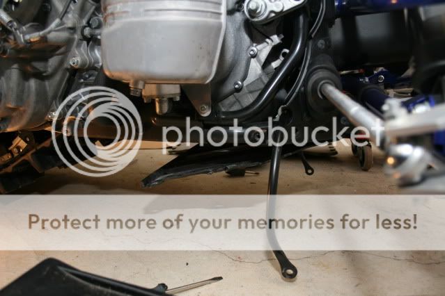

Disconnect stabilizer joint from lower arm and let sway bar hang down
I didn't remove the rubber boots or any rivets around steering rods just bend them out of the way to reveal the bolt on top that needs to be removed. This pressure is minimal and doesn't hurt.
Now the fun part. I ended up cutting my allen wrench to make it maybe a 3/16-1/4" shorter so it would fit on the bolt. There really isn't much room here. Time to add some heat. I think it is a must to remove these bolts because they are on tight. Make sure the allen wrench is well seated. I used a small diameter pipe on the end of the wrench to help crank it.
Now we're in business. The top bolts are hardest to come out due to the lack of room. Bottom comes much easier but still need heat. Didn't even melt the plastic bushings so this can all be re-installed if need be. Store on shelf all bolts, bushings, bar and stabilizer holders just in case.
Bottom bolt. Careful not to melt any plastic.
There we go all done. Well still have some work to do. Looking forward to the first ride without a sway bar.

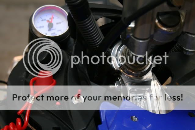

YAMAHEATER
Next Mod, " Warm Hands" and like many others I went with
YAMAHEATER PLUG AND PLAY
After you install this you will wish you did it earlier. I know I do.
Very easy install and simple instructions to follow. Take your time and little over an hour and your done.
Here's a quick link.
http://www.ty4stroke.com/viewtopic.php?t=67236

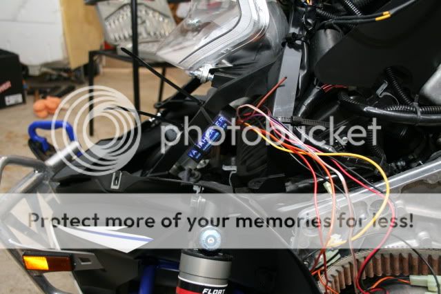

Mounted on left hand side of sled.

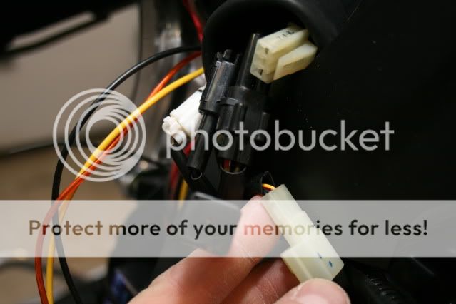

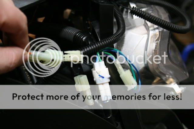

All you have to do is locate a few connectors under the rubber boots on the right and left of sled. A couple connectors go to the grip connectors, one to ECU and a couple to brake controller. Power comes from the brake connector.
Right side
Left
Ground wire
Two holes drilled to install Led and mode switch.
Initial thought was wow, haven't felt this kind of heat yet. Nice and warm in
less than a minute. Thanks for the toasty hands Rockmeister
