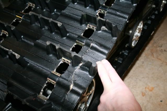

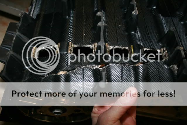

Checking my slides friday night and came across this. I hooked up the track into some rock under a couple feet of powder.
As you can see the fiberglass bars in the track are broken.
Going on a trip in 6 days and no new Backcountry tracks in the City. Hmmm...

that sucks. send it to a track repair place. there are places that can make that almost as good as new for far less than the cost of a new one.
