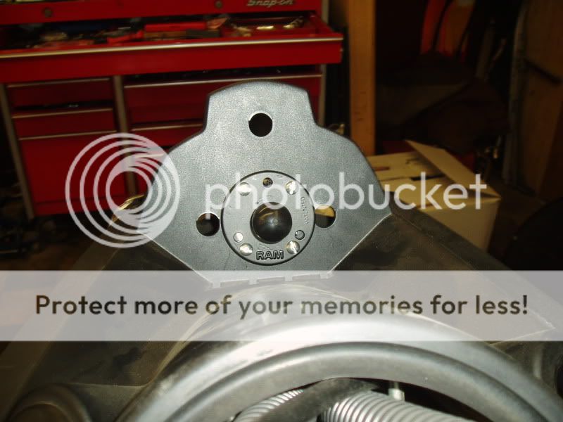

This is how I did the Vector gauge mounting to the FX Nytro panel. I bought a RAM mount and located it and now have an adjustable gauge!
Drilled the hole pattern into the stock gauge location.
Made an aluminum "backing plate" to give the plastic a little rigidity.
Base installed.
Then I measurened the hole center to center and drilled it into the other end of my RAM mount.
Installed the rubber grommets and screws!
Short, tall position!
Extended reach position!
Base installed.

Allen, good thought on the mount, how bouncy do you think it will be? I know there isnt allot of suport on that plastic panel.
- Apr 17, 2003
- 5,553
- 1,441
- 2,003
- Menno, SD
- www.ulmerracing.com
- Menno, SD
stopdropanroll said:Allen, good thought on the mount, how bouncy do you think it will be? I know there isnt allot of suport on that plastic panel.
It seems to be pretty solid actually. I thought it would bounce as well, but with the hoods, etc on it all seems to be pretty stable. Only time will tell!
