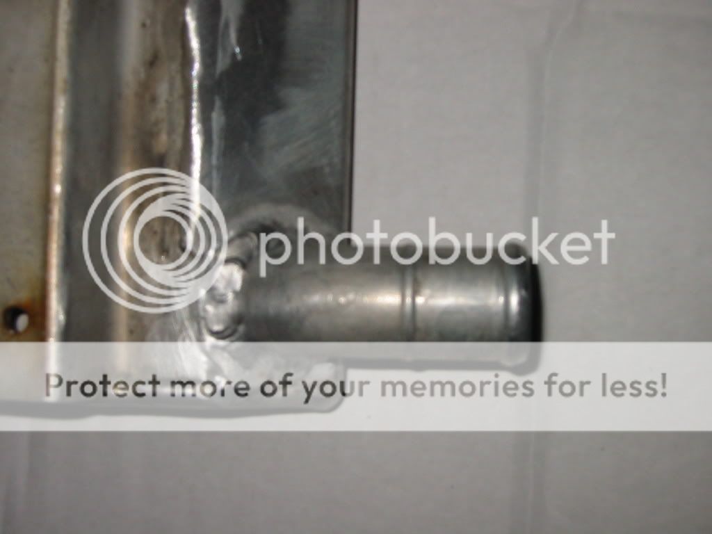

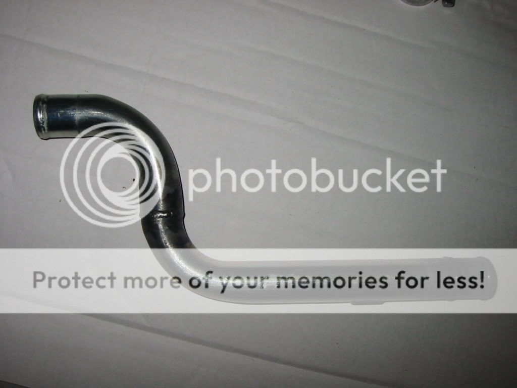

Here is an idea how to do the rear heat exchanger. Have it re-welded, use 2 OEM cross-tubes - this will make you able to put the heat exchanger flush with the tunnel extension. Then there is no chance for the track paddles to hit the heat exchanger. With a setup like this the rear plastic will cover up the hoses coming from the runningboard heat exchangers.
I and friend have ran this setup since we installed MPI tunnel extension. It works flawlessly
