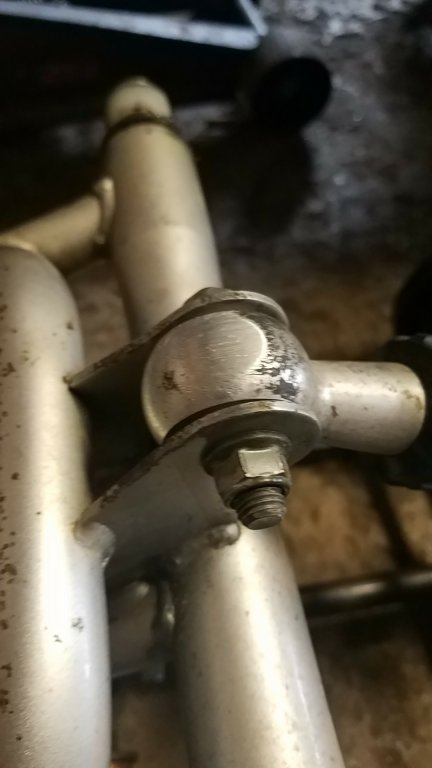

Mmm good point, I'll tear more into it tonight , trying to find parts and peices now wheels bearibgs ect.. , I'll get the wheels replaced .. then degrease/ pressure wash the skid and throw some rattle can paint on it .... The skid it's self looks pretty straight forward , no cracks in the arms or anything.. I did see the rub on the mono shock from the track .. worn it pretty good.. thinking maybe just take the bolt out and spin that end so the other side starts to wear lol, I don't I have a welder otherwise I'd fab up a chunk to cover itif there is a snap ring holding the bearing in they are. i do remeber the 02 viper rear uppers where non serviceable from factory but the srx wheels where the same and serviceable. never had a mono skid sled to service so i cannot tell you for certain.

there is a kit for the shock wear issue. Basically a longer upper bolt and a pair of bearings for the track to ride on I don't think the shock can go in upside down and clear everything but I could be wrong. be certain to route the wire for the shock the correct way and zip tie the heck out of it or the wire will break.

I ment only spin around the one end that's rubbing .. who sells this kit for the shock ? I'd deffinitlylike to look into that... Ok edit ..I see ulmers makes a kit for this . $25 for a bolt and two bearings.. deff gunna get that, if it wears any further it will start to wear in the little ears that hold that eyebolt and metal rubbin on the track is not good !there is a kit for the shock wear issue. Basically a longer upper bolt and a pair of bearings for the track to ride on I don't think the shock can go in upside down and clear everything but I could be wrong. be certain to route the wire for the shock the correct way and zip tie the heck out of it or the wire will break.
